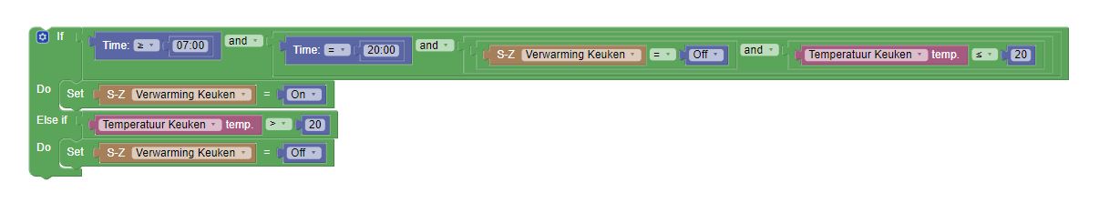

I have set up the following event in blockly:
My intention is the following:
If between 7 and hours
if switch is Off
if temperature <= 20
set switch on
if temp > 20
set switch off
However the event is not making any changes although switch = off and temperature is below 20.
The event is active :mrgreen:
What am I missing?

The On logic will ONLY be true at 20:00 as you test for: Time = 20:00.

Trying to expand my logic such that I have a different event logic in the weekend compared to weekdays.
It is now Sunday 12:15 and my temperature gives 19,3 degrees, why is the device not switched ON?
If I switch it on manually, it remains ON?

Nested If's don't work in Blockly as far as I know. I always use LUA scripts for any logic, but you could also use DzVents scripts.
