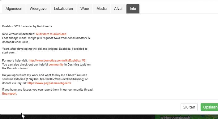

Did you install the beta version of Dashticz and PHP according to the installation instructions? Then the calendar module should work...
Please check that PHP is configured correctly:
Open the Dashticz s settings (settings icon right top), info tab: What is the Dashticz version and PHP version that is reported?
In CONFIG.js remove all settings related to CORS. (not needed anymore)
Can you post your calendar definition from CONFIG.js here? (hide your private info)

Only in the info tab:
And i see no Php
{maxitems: 15, 	icalurl: 'https://calendar.google.com/calendar/ical/aname%40gmail.com/private-3592da1ad5731667df1d6ea83/basic.ics' }
Where do i find this:
In the config i cannot find them..

@Derik: You are running a master version, not the latest beta. Latest beta can be downloaded here https://github.com/Dashticz/dashticz_v2/tree/beta
Blah blah blah

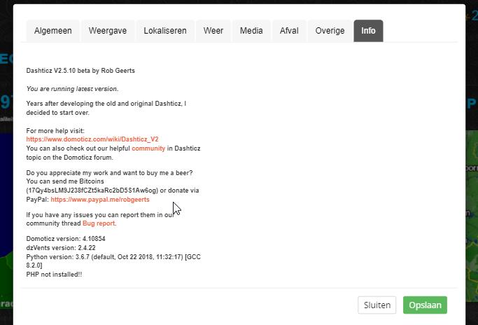

mmm did thinking that i had the latest beta..
Now i have:
Only Putty says php installed
And dashticz says not??
Lokonli
Posts: 2292
Re: dashticz: Important Request
Post by Lokonli »
Derik wrote: Thursday 06 June 2019 22:06 mmm did thinking that i had the latest beta..
Now i have:
Did you install all required php modules?
For php with Apache:
sudo apt-get install php-xml php-curl libapache2-mod-php
sudo systemctl restart apache2
Are you using Apache webserver url? (not your Domoticz ip:port)
Check the installation instructions just to be sure:
https://dashticz-v2.readthedocs.io/en/l ... setup.html

@lokonli,
I did:
pi@odroid:~$ sudo apt-get install php-xml php-curl libapache2-mod-php
Reading package lists... Done
Building dependency tree
Reading state information... Done
libapache2-mod-php is already the newest version (1:7.2+60ubuntu1).
php-curl is already the newest version (1:7.2+60ubuntu1).
php-xml is already the newest version (1:7.2+60ubuntu1).
0 upgraded, 0 newly installed, 0 to remove and 0 not upgraded.
pi@odroid:~$ sudo systemctl restart apache2
pi@odroid:~$
Strange other thing
everything double check
i run some other php scripts that are working fine?
This ok?

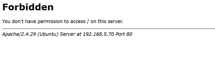

Via which path do you open Dashticz? (on port 80)
Derik
Posts: 1605
Post by Derik »
Lokonli wrote: Friday 07 June 2019 7:45 Via which path do you open Dashticz? (on port 80)
http://192.168.5.70:8080/dashticz_v2/index.html
Lokonli
Posts: 2292
Post by Lokonli »
Derik wrote: Friday 07 June 2019 8:24
You open Dashticz via port 8080. I guess Domoticz is running on this port. The Domoticz web server doesn't support PHP, That means also the PHP functionality in Dashticz will not work (like calendar, tv guide and a few more)
To fix this, try to follow the Dashticz installation instructions. First step is to have Apache web server running correctly. You should see the default Apache webpage when you open http://192.168.5.70
You have a slightly different system (Ubuntu) on different hardware, so in your case the way on how to install Apache might be slightly different. There are sufficient guides on the web for this if you need help.
Next step is to make Dashticz accessible via Apache.
Normally the web-root folder of Apache is /var/www/html
You have to copy the complete dashticz_v2 folder to this location (/var/www/html/dashticz_v2/) or you create a symlink in /var/www/html to the current position of the dashticz_v2 folder. The installation guide contains the instructions for this.
Dashtics should then become available via http://192.168.5.70/dashticz_v2
(so default port 80, not port 8080)
