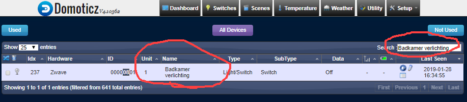

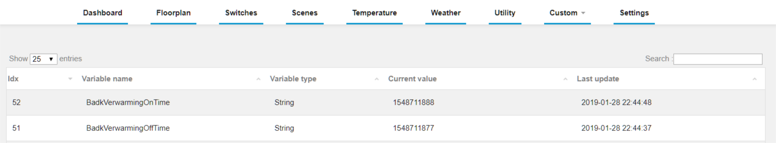

Having some troubles on detecting if a script is triggered by a timerrule or device.
I have the following test event;
	    timer = {'every 15 minutes'},
		devices = {'Badkamer verlichting'}
	execute = function(domoticz, device, triggerInfo)
	    if(device.isDevice)then
	            domoticz.variables('BadkVerwarmingOnTime').set(os.time())
	    	    domoticz.variables('BadkVerwarmingOffTime').set(os.time())
	    	    device.dump()
When running this code only when switching the "Badkamer verlichting" On, the variables are updated.
When switching the device Off, nothing happens.
I tried to debug with some notifications and the loggin page and from execute line till the last "}", all notifications are send/received.
Also tried to dump the "device" variable and I noticed that only when the device is switch On, the paramater isDevice is precence.
When switch off, the parameter isScene is precence with the value "False".
So it looks like there's something wrong with this.
Don't no whats going on and/or what i'm doing wrong....
Hope somebody can help :)

OK could it be the case that you have 'Badkamer verlichting' more than one time in your devices / groups or scenes ?
Freemann
Posts: 94
Joined: Thursday 24 November 2016 14:55
Domoticz version: >=Béta
Re: .isDevice not always avalaible in item
Post by Freemann »
That's not the case;
Screenshot - 28_01_2019 , 16_44_15.png (33.31 KiB) Viewed 2624 times
Tried to remove the space from the devicename, so I changed the name from "Badkamer verlichting" to "Badkamerverlichting" and that solved the problem.
So it looks like the device name is the problem and most likely its something to do with the space in the name?!

Freemann wrote: Monday 28 January 2019 21:21 Then tried with an ON/OFF cycle with device "Badkamer verlichting"
- "Badkamer verlichting Off", uservariables not set
Very strange domoticz dzVents on my system reacts different.

relevant log
2019-01-28 22:44:37.489  Status: dzVents: Info:  Handling events for: "isDevice Test", value: "On"
2019-01-28 22:44:37.489  Status: dzVents: Info:  isDevice check: ------ Start external script: dumper103.lua: Device: "isDevice Test (Virtual2)", Index: 1477
2019-01-28 22:44:37.490  Status: dzVents: Debug: isDevice check: triggered by isDevice Test; state: On; isDevice        true
2019-01-28 22:44:37.490  Status: dzVents: Debug: isDevice check: triggered by isDevice Test; state: On; isVariable      false
2019-01-28 22:44:37.490  Status: dzVents: Debug: isDevice check: triggered by isDevice Test; state: On; isScene         false
2019-01-28 22:44:37.490  Status: dzVents: Debug: isDevice check: triggered by isDevice Test; state: On; isGroup         false
2019-01-28 22:44:37.490  Status: dzVents: Debug: isDevice check: triggered by isDevice Test; state: On; isTimer         false
2019-01-28 22:44:37.490  Status: dzVents: Debug: isDevice check: triggered by isDevice Test; state: On; isSecurity      false
2019-01-28 22:44:37.490  Status: dzVents: Debug: isDevice check: triggered by isDevice Test; state: On; isHTTPResponse  false
2019-01-28 22:44:37.490  Status: dzVents: Debug: isDevice check: setting uservar BadkVerwarmingOffTime to 1548711877
2019-01-28 22:44:37.492  Status: dzVents: Info:  isDevice check: ------ Finished dumper103.lua
2019-01-28 22:44:37.506  Status: Set UserVariable BadkVerwarmingOffTime = 1548711877
2019-01-28 22:44:48.657  Status: User: Admin initiated a switch command (1477/isDevice Test/Off)
2019-01-28 22:44:48.669  (Virtual2) Light/Switch (isDevice Test)
2019-01-28 22:44:48.918  Status: dzVents: Info:  Handling events for: "isDevice Test", value: "Off"
2019-01-28 22:44:48.919  Status: dzVents: Info:  isDevice check: ------ Start external script: dumper103.lua: Device: "isDevice Test (Virtual2)", Index: 1477
2019-01-28 22:44:48.919  Status: dzVents: Debug: isDevice check: triggered by isDevice Test; state: Off; isDevice        true
2019-01-28 22:44:48.920  Status: dzVents: Debug: isDevice check: triggered by isDevice Test; state: Off; isVariable      false
2019-01-28 22:44:48.923  Status: dzVents: Debug: isDevice check: triggered by isDevice Test; state: Off; isScene         false
2019-01-28 22:44:48.923  Status: dzVents: Debug: isDevice check: triggered by isDevice Test; state: Off; isGroup         false
2019-01-28 22:44:48.923  Status: dzVents: Debug: isDevice check: triggered by isDevice Test; state: Off; isTimer         false
2019-01-28 22:44:48.923  Status: dzVents: Debug: isDevice check: triggered by isDevice Test; state: Off; isSecurity      false
2019-01-28 22:44:48.923  Status: dzVents: Debug: isDevice check: triggered by isDevice Test; state: Off; isHTTPResponse  false
2019-01-28 22:44:48.923  Status: dzVents: Debug: isDevice check: setting uservar BadkVerwarmingOnTime to 1548711888
2019-01-28 22:44:48.925  Status: dzVents: Info:  isDevice check: ------ Finished dumper103.lua
2019-01-28 22:44:48.942  Status: Set UserVariable BadkVerwarmingOnTime = 1548711888
uservars set by isDevice test script

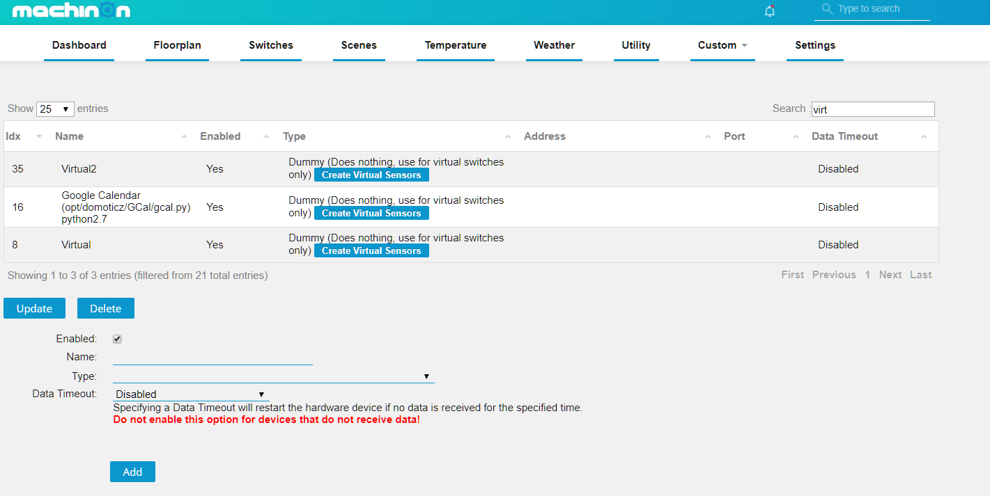

I now see three difference in my case with your's;
1. I'm using a Z-Wave device, yours is a virtual device, on which I switch from the Domoticz main dashboard view,
2. Not the same device name,
3. The length of the device name, mine is "Badkamer verlichting" (20 chars), your "isDevice Test"(13 chars)
I will try to test with a Virtual device and the same name as you use.
Maybe that will shine some light on it....
[edit]
Want to test with a "Virtual2" device, but how to create such a device?
Domotica/graphs "freak" :)
NUC8i3BEH(8gb/250gb),
Lubuntu 19.04,
Aeotec Z-Stick S2(Gen5)
HarmonyElite
HUE(5 bulbs, 2 blooms)
NetAtmo(complete setup)
MiLight iboxV6(2 MiLightBulbs)
IP-Cam
https://www.frijduurzaam.nl
Re: UserVariables not always set after Device Trigger Off[edit]
Freemann wrote: Tuesday 29 January 2019 9:55 Want to test with a "Virtual2" device, but how to create such a device?
virtual2 is the name of one my Dummy hardware :D
virtual (Dummy) hardware

Freemann
Posts: 94
Post by Freemann »
log:
2019-01-30 08:38:04.143  OpenZWave: Domoticz has send a Switch command! NodeID: 8 (0x08)
2019-01-30 08:38:04.162  (Zwave) Light/Switch (Badkamer verlichting)
2019-01-30 08:38:04.186  (Zwave) General/Voltage (Voltage)
2019-01-30 08:38:04.497  Status: dzVents: Info:  isDevice check: ------ Start internal script: BadkamerTest: Device: "Badkamer verlichting (Zwave)", Index: 237
2019-01-30 08:38:04.517  Status: dzVents: Debug: isDevice check: devices = "Badkamer verlichting"
2019-01-30 08:38:04.518  Status: dzVents: Debug: isDevice check: triggered by Badkamer verlichting; state: On; isDevice        true
2019-01-30 08:38:04.518  Status: dzVents: Debug: isDevice check: triggered by Badkamer verlichting; state: On; isVariable      false
2019-01-30 08:38:04.518  Status: dzVents: Debug: isDevice check: triggered by Badkamer verlichting; state: On; isScene         false
2019-01-30 08:38:04.518  Status: dzVents: Debug: isDevice check: triggered by Badkamer verlichting; state: On; isGroup         false
2019-01-30 08:38:04.518  Status: dzVents: Debug: isDevice check: triggered by Badkamer verlichting; state: On; isTimer         false
2019-01-30 08:38:04.518  Status: dzVents: Debug: isDevice check: triggered by Badkamer verlichting; state: On; isSecurity      false
2019-01-30 08:38:04.518  Status: dzVents: Debug: isDevice check: triggered by Badkamer verlichting; state: On; isHTTPResponse  false
2019-01-30 08:38:04.518  Status: dzVents: Debug: isDevice check: #######################################################################
2019-01-30 08:38:04.518  Status: dzVents: Debug: isDevice check: test:: >> if(item.isDevice or item.isTimer)then >>
2019-01-30 08:38:04.518  Status: dzVents: Debug: isDevice check: next line shoud be ''in test:: >> if(item.isDevice or item.isTimer)then >>''
2019-01-30 08:38:04.518  Status: dzVents: Debug: isDevice check: in test:: >> if(item.isDevice or item.isTimer)then >>
2019-01-30 08:38:04.519  Status: dzVents: Debug: isDevice check: this line is after the .set()
2019-01-30 08:38:04.524  Status: dzVents: Info:  isDevice check: ------ Finished BadkamerTest
2019-01-30 08:38:04.689  (Zwave) General/kWh (kWh Meter)
2019-01-30 08:38:04.740  Status: Notification: 1548833884
2019-01-30 08:38:05.187  (Zwave) Current (Unknown)
2019-01-30 08:38:05.204  Notification sent (gcm) => Success
2019-01-30 08:38:05.605  (Zwave) Usage (Unknown)
2019-01-30 08:38:05.606  (Zwave) General/kWh (kWh Meter)
2019-01-30 08:38:06.349  Notification sent (email) => Success
2019-01-30 08:38:06.604  (Zwave) General/Voltage (Voltage)
2019-01-30 08:38:06.744  Status: Set UserVariable BadkVerwarmingOffTime = 1548833884
2019-01-30 08:38:06.745  Status: Set UserVariable BadkVerwarmingOnTime = 1548833884
2019-01-30 08:38:07.603  (Zwave) Current (Unknown)
2019-01-30 08:38:17.664  Status: User: Admin initiated a switch command (237/Badkamer verlichting/Off)
2019-01-30 08:38:17.665  OpenZWave: Domoticz has send a Switch command! NodeID: 8 (0x08)
2019-01-30 08:38:17.674  (Zwave) Light/Switch (Badkamer verlichting)
2019-01-30 08:38:17.918  Status: dzVents: Info:  isDevice check: ------ Start internal script: BadkamerTest: Device: "Badkamer verlichting (Zwave)", Index: 237
2019-01-30 08:38:17.938  Status: dzVents: Debug: isDevice check: devices = "Badkamer verlichting"
2019-01-30 08:38:17.939  Status: dzVents: Debug: isDevice check: triggered by Badkamer verlichting; state: Off; isDevice        true
2019-01-30 08:38:17.939  Status: dzVents: Debug: isDevice check: triggered by Badkamer verlichting; state: Off; isVariable      false
2019-01-30 08:38:17.939  Status: dzVents: Debug: isDevice check: triggered by Badkamer verlichting; state: Off; isScene         false
2019-01-30 08:38:17.939  Status: dzVents: Debug: isDevice check: triggered by Badkamer verlichting; state: Off; isGroup         false
2019-01-30 08:38:17.939  Status: dzVents: Debug: isDevice check: triggered by Badkamer verlichting; state: Off; isTimer         false
2019-01-30 08:38:17.939  Status: dzVents: Debug: isDevice check: triggered by Badkamer verlichting; state: Off; isSecurity      false
2019-01-30 08:38:17.939  Status: dzVents: Debug: isDevice check: triggered by Badkamer verlichting; state: Off; isHTTPResponse  false
2019-01-30 08:38:17.939  Status: dzVents: Debug: isDevice check: #######################################################################
2019-01-30 08:38:17.939  Status: dzVents: Debug: isDevice check: test:: >> if(item.isDevice or item.isTimer)then >>
2019-01-30 08:38:17.939  Status: dzVents: Debug: isDevice check: next line shoud be ''in test:: >> if(item.isDevice or item.isTimer)then >>''
2019-01-30 08:38:17.939  Status: dzVents: Debug: isDevice check: in test:: >> if(item.isDevice or item.isTimer)then >>
2019-01-30 08:38:17.940  Status: dzVents: Debug: isDevice check: this line is after the .set()
2019-01-30 08:38:17.945  Status: dzVents: Info:  isDevice check: ------ Finished BadkamerTest
2019-01-30 08:38:18.108  Status: Notification: 1548833897
2019-01-30 08:38:18.586  Notification sent (gcm) => Success
2019-01-30 08:38:18.686  (Zwave) General/kWh (kWh Meter)
2019-01-30 08:38:19.113  OpenZWave: Domoticz has send a Switch command! NodeID: 6 (0x06)
2019-01-30 08:38:19.116  (Zwave) Usage (Badkamer Verwarming(Watt))
2019-01-30 08:38:19.137  (Zwave) General/kWh (Badkamer Verwarming(kWh))
2019-01-30 08:38:19.142  (Zwave) Light/Switch (Badkamer Verwarming)
2019-01-30 08:38:19.554  Notification sent (email) => Success
2019-01-30 08:38:19.605  (Zwave) Usage (Unknown)
script code:
-- isDevice check
    on =        {
        --timer = {"every minute"},
                     devices  = {
                         --237,
                    }},  -- 433 is sensor / isDevice Test switch
        logging =   {
                        level     =   domoticz.LOG_DEBUG,       -- change to LOG_ERROR after you tested  the script
                        marker    =   "isDevice check"
    execute = function(dz, item, info )
        local function logWrite(str,level)             -- Support function for shorthand debug log statements
            dz.log(tostring(str),level or dz.LOG_DEBUG)
        local trigger   = item.name
        local state     = item.state
        if info.trigger then
            trigger = info.trigger
            state   = "N/A"
        --logWrite("devices = {237}")
        logWrite('devices = "Badkamer verlichting"')
        logWrite("triggered by " .. trigger .. "; state: " .. state .. "; isDevice        " .. tostring(item.isDevice ))
        logWrite("triggered by " .. trigger .. "; state: " .. state .. "; isVariable      " .. tostring(item.isVariable ))
        logWrite("triggered by " .. trigger .. "; state: " .. state .. "; isScene         " .. tostring(item.isScene))
        logWrite("triggered by " .. trigger .. "; state: " .. state .. "; isGroup         " .. tostring(item.isGroup))
        logWrite("triggered by " .. trigger .. "; state: " .. state .. "; isTimer         " .. tostring(item.isTimer))
        logWrite("triggered by " .. trigger .. "; state: " .. state .. "; isSecurity      " .. tostring(item.isSecurity))
        logWrite("triggered by " .. trigger .. "; state: " .. state .. "; isHTTPResponse  " .. tostring(item.isHTTPResponse))
        logWrite("#######################################################################")
        logWrite("test:: >> if(item.isDevice or item.isTimer)then >>")
        logWrite("next line shoud be ''in test:: >> if(item.isDevice or item.isTimer)then >>'' ")
            logWrite("in test:: >> if(item.isDevice or item.isTimer)then >>")
                dz.variables("BadkVerwarmingOffTime").set(os.time()).afterSec(2)
                dz.variables("BadkVerwarmingOnTime").set(os.time()).afterSec(2)
                dz.notify(os.time())
            logWrite("this line is after the .set()")
So when using the Zwave device to switch its not setting the UserVariables after a Off Command, but it's send a Notification....
When using a dummy on both Off/On its setting the UserVariables and send a notification...
I'm lost here.....
Freemann wrote: Wednesday 30 January 2019 8:58 So when using the Zwave device to switch its not setting the UserVariables after a Off Command, but it's send a Notification....
I'm lost here.....
What does the UserVariables tab show after a reload page ?
