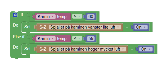

i have managed to automate my stove, and i have some problems with my blockly config.
as for now, the electric motor starts when the temperatur goes over 60 degrees, but the problem is that the motor continues to go everytime the temp sensor register an increase in the temperatur, how can i do the blockly setup so the motor starts only one time when it goes over 60 degrees?

I must ad that the motor that i controlled by the blockly is automatically turn of after 1 second, so it is not continusly running, but with this blockly setup it keeps turning on every time the temperatur goes over 60 degrees

tjabas wrote: Sunday 27 January 2019 18:24 Hi!
Try adding in the condition like. AND IF THE SWITCH = OFF and in the second THE SWITCH = ON
