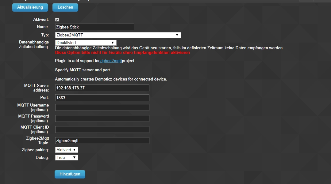

jvbussel
- Posts: 8
- Joined: Friday 12 July 2013 17:14
Re: Zigbee2MQTT
I do think I did not configure any authentication for mosquitto. That’s why I did not enter a username/password in configuration.yaml
The mosquitto client showed output on all my domoticz devices without passing credentials either.
salopette
- Posts: 187
- Joined: Tuesday 07 March 2017 21:03
- Domoticz version: BETA
- Location: Germany
Re: Zigbee2MQTT
I also do not have a login for mqtt,
But if you have login you have to install it in domoticz plugin
- sshot-2019-02-06-[1].jpg (167.76 KiB) Viewed 6332 times
jvbussel
- Posts: 8
Re: Zigbee2MQTT
In the mosquitto configuration file there is currently allow_anonymous true
That’s why I did not fillin the username/password.
You are correct, when you do configure username/password you have to supply them in the Domoticz plugin. However this is not the case for now.

I made a fresh install of domoticz and upon starting, it immediately got it's devices from the stick and made them available in the devices overview.
The only thing not working is the link quality indicator. It remains always at 0.
