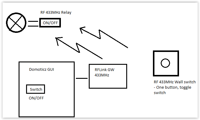

I have a problem with the lamp switch (toggle switch).
Scheme layout below:
I would like to control the lamp in two ways: using the switch on the wall (one gang) or using the button in the GUI Domoticz.
The switch on the wall is one-button(toggle).
I would also like that after pressing the switch on the wall, the status of the lamp (on / off) changed on the switch in the GUI Domoticz.
Is anyone able to help?

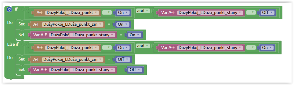

and Blocky:
Screen Shot 01-26-19 at 04.52 PM.PNG (34.54 KiB) Viewed 378 times
Where:
"DużyPokój_LDuża_punkt" = "Lamp"
"DużyPokój_LDuża_punkt_zm" = "Lamp_1"
"DużyPokój_LDuża_punkt_stany" = "Lamp_variable"
I also tried in different combinations with the triggers on the buttons (json trigers), unfortunately without successes :oops:
