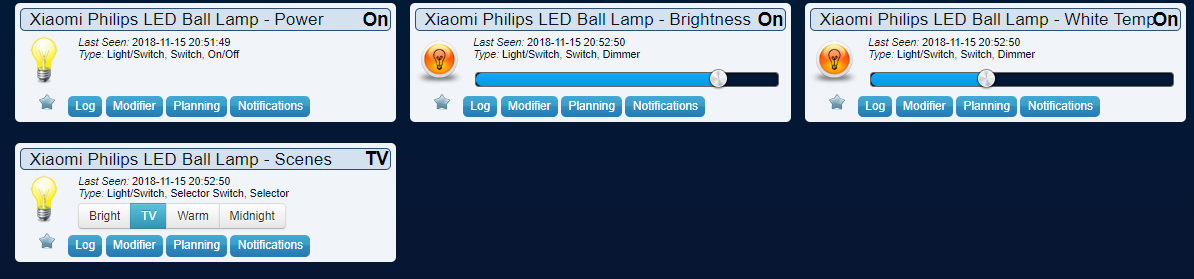

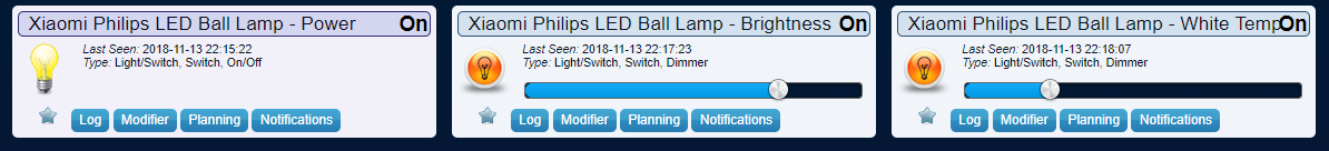

Hello There
I'm starting a new plugin, for some Xiaomi Philips Wifi Device.
All main work come from Kofec and his plugin for Xiaomi Air Purifier : https://github.com/kofec/domoticz-AirPurifier
I just spend some time to adapt it for the E27 Bulb aka Xiaomi Philips LED Ball Lamp aka Philips ZhiRui E27 bulb.
That a first version, With 3 Widgets
ON/OFF
Brightness
White Temp
You Can drive the Bulb directly from Domoticz and from MiHome APP (set refresh to 1 minute to have best update)
Know Issue :
- Restarting the plugin create a segmention Fault, you need to restart your domoticz
- Plugin doesn't know if your bulb are Online or not
Next evolutions are :
Using Native Domoticz CCCW Widget
Using set_brightness_and_color_temperature(brightness, cct) command avaiable on Python-miio
You can Grab it : https://github.com/deennoo/domoticz-Xia ... ree/master

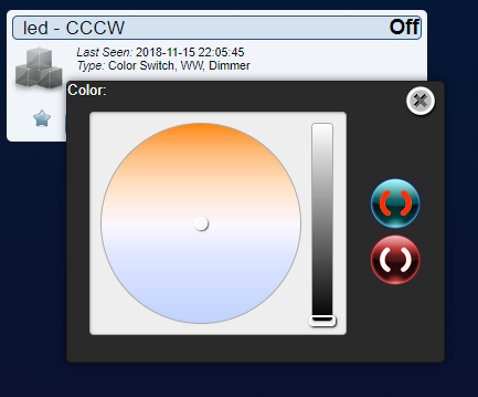

deennoo
Posts: 784
Location: Bordeaux France
Re: Python Plugin : Xiaomi Philips LED Ball Lamp
Post by deennoo »
switching to beta branch allow you to use cccw widget
https://github.com/deennoo/domoticz-Xia ... /MyBulb.py
just missing now :
on/off from this widget
refresh this widget from bulb status
using native python-miio module to by pass MyBulb.py
http://domo-attitude.fr

yezzer wrote: Wednesday 23 January 2019 20:31
about the integration in my version of domoticz (bèta V4.10363 with python 3.5.3):
I only get two tabs, namely the tab with the predefined 4 scènes and the tab with CCCW
the other tabs are missing...
Other tab was created for beta, but removed because not needed as i manage to create and use a cccw widget
