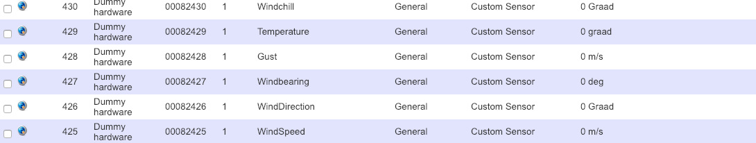

I'm trying to create a Lua script to split data from a combined virtual sensor into several virtual sensors in order to display just the info to fit in a single frontpage.html cell.
Schermafbeelding 2019-01-18 om 16.56.18.png (87.59 KiB) Viewed 914 times

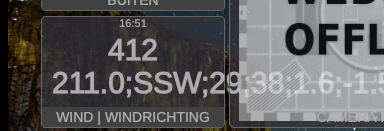

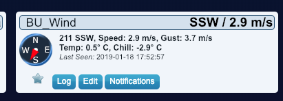

So all the requested information is available in a virtual device.
Schermafbeelding 2019-01-18 om 17.53.43.png (29.99 KiB) Viewed 914 times
Schermafbeelding 2019-01-18 om 17.27.16.png (60.33 KiB) Viewed 914 times
Therefore I like to create a Lua script but until now without success.
