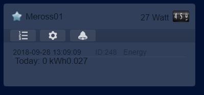

Well here is the python program to get the power value and set the virtual sensor.
This code is based on the following github: https://github.com/albertogeniola/MerossIot
Just install and create the following python:
Next step it be the ability to access the device directly.import time

You need to create a dummy device type P1 Smart Meter and set the value with a URL:Marv wrote: Thursday 10 January 2019 14:05 @CLEMENT99
Any chance you could elaborate on how you got this working, i am just setting up a Domoticz server and i have a few of these around the house.
TIA
# Parsing URL
httpurl = 'http://user:password@domoticz-ip-addres ... idx=Device ID&nvalue=0&svalue='+str(output_h)+';0;0;0;'+str(output_n)+';0'
# Sending data to Domoticz
r = requests.get(httpurl)
This is only to get the value.
To swith on/off with domotics, plese follow emme sample.

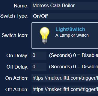

Yes, it's also possbile to use IFTTT
Create a dummy device type switch.
Create 2 applets in IFTTT
In domoticz settings specify your IFTTT credentials
Change dummy device to call applets (see below) with the applet name and key
sample call -> https://maker.ifttt.com/trigger/applet- ... applet-key
