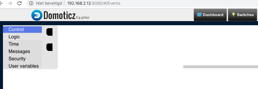

I also do have a similar situation. I have 2 systems running, 1 is V3.8153 with running events and visual events overview and working blocky mode and a second system running V 4.9700 with event problems. After importing the database from V3.8153 into V4.9700 the old events are running well, but the user interface is not visible. Only some black blocks are visible. I’m also not able to see a list of existing and correct imported and working events. The EventSystem (Lua/Blockly/Scripts) are set correctly. (Both interfaces are running simultaneously with the same browser)
Schermafbeelding 2018-12-02 om 18.58.58.png (41.22 KiB) Viewed 3755 times
