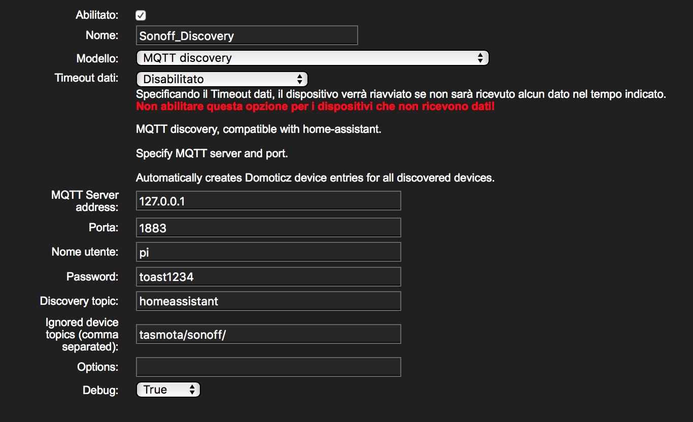

Hi all, I have Domoticz Version: 3.9389 and Tasmota Program Version 5.13.1.
Domoticz auto discover the sonoff devices and I can control them with domoticz or Hardware button.
But if I stop domoticz service, manually change relais status and then re-enable domoticz, the status of the relais are not updated anymore.
I think I have done something dirty but I can't understand what... I post the screen of my config..
Thanks for help :)

I want to add some new flashed Sonoff devices to Domoticz but i can't get them in to Domoticz. Did this before and was always working fine and still working nice with the existing ones.
Setup Tasmota on the device the same way as the older ones with only different topic name.
In Tasmota i added setoption19 1 in console so it sets to ON.
Sonoff-Tasmota 6.4.1 version
Debug log and it is seeing the name i gave it Ender 3 Printer, so there is some communication. But when i search in Domoticz devices tab or list there is nothing. Tried the Allow for 5 minutes option just te be sure but makes no difference.
Any tips?

Flashed Tasmota 6.1.1 what I am using for the older S20 i am using already and now the new S20 is discovered fine.
So problem is with newer version of Tasmota.
One thing i noticed
With version v6.1.1 the log shows
00:00:07 MQT: homeassistant/switch/sonoff230_3/config =  (retained)
With version v6.4.1 the log shows
2019-01-14 15:07:01.764 (MQTT Discovery) onMQTTPublish: homeassistant/switch/375D17_RL_4/config:b''
Topic is different. With the new versions it shows a part of the MAC address even when i filled the setting exactly the same as with v6.1.1

It will be fixed with next update of the MQTT Disovery plugin. See also https://github.com/emontnemery/domoticz ... /issues/12
