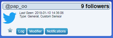

this script allows you to follow any twitter account, not necessarily yours
2019-01-10 14_36_58-Domoticz.png (7.47 KiB) Viewed 540 times
