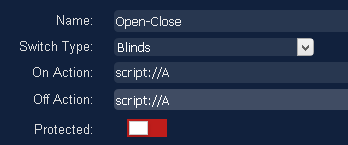

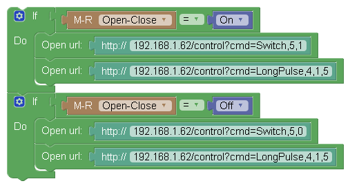

Re: Blockly examples Script not found
Hello I am new on this forum
I use Domoticz on a Synology NAS to control some ESP Easy units
Version: 4.9700
Build Hash: a3a4590-modified
Compile Date: 2018-06-23 16:24:51
dzVents Version: 2.4.6
Python Version: None
With one switch I want to send 2 HTTP commands to the ESP easy unit
So I use blockly to make the 2 commands with One switch see screenshoot attached The file is named "A"
In the switch setting I have put : On action : script://A
When I turn on the switch I have a log error as follow :
2018-12-28 22:00:34.299 (Switches) Light/Switch (Open-Close)
2018-12-28 22:00:34.298 Status: User: Admin initiated a switch command (8/Open-Close/On)
2018-12-28 22:00:34.298 Error: SQLHelper: Error script not found '/usr/local/domoticz/var/scripts/A'
Can somebody tell me what I am doing wrong ?
Thanks in advance
Patou

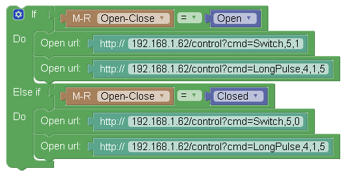

Hello again,
I found my mistake ....
The 2 blocks must be linked with the else if statement
Hope this can help somebody else ...
Patou
