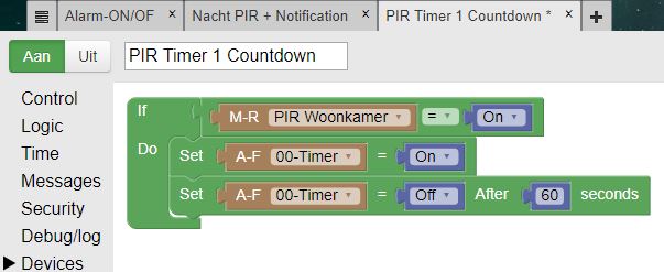

Normally all the light goes out at 23.00. But if a movement is detected in the living room, I want to increase a timer by 10 minutes. When the timer count down to zero, a group switch will turn off the lights. For the time being I do not see any possibility within blockey. Look forward to a nice tip

You could try this, using a virtual switch, and 2 blocklyd.
1:
If sensor = on
Set virtual switch = on
Set virtual switch = off after 600 seconds.
( or a time you want ).
2:
If time = ((after 23:00 or before 06:00) and virtual switch = off)
Set yourGroup = off.
1:
If sensor = on
2:

Thank you @Sion, I can continue to work out the complete flow
This part is working.
