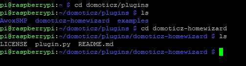

i did the steps:
cd domoticz/plugins
git clone https://github.com/rvdvoorde/domoticz-homewizard.git
sudo systemctl restart domoticz
and i see in my raspbian,
but i dont see in in Hardware antthing of homewizard ?,i already try a reset in domoticz

update,
solved the problem, if you also got the same error like above go to Putty and install manual Python with the commando sudo apt-get install python3-pip
tnx,
