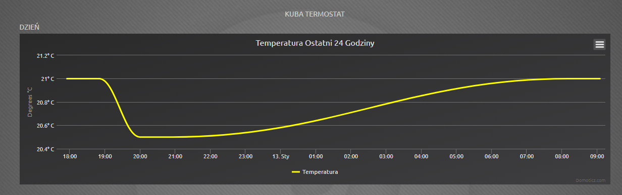

Is it possible for the thermostat to report the set temperature all the time? Currently, if one change is at 8pm and the next one at 8am, there are no points between and a rounded line appears on the graph. It would be good if there were more between these points, with the value set at 8pm.
https://imgur.com/a/rQBbBVl
- eq3max_domoticz.png (100.64 KiB) Viewed 2810 times

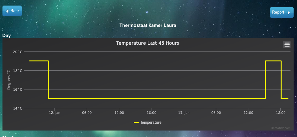

For some reason, my graphs look different from yours (see below)! They are nice and straight, even though the values are only updated when they change value. No idea why you have this smoothing effect. Which version of Domoticz do you use?maks87 wrote: Sunday 13 January 2019 17:37 Is it possible for the thermostat to report the set temperature all the time? Currently, if one change is at 8pm and the next one at 8am, there are no points between and a rounded line appears on the graph. It would be good if there were more between these points, with the value set at 8pm.
How do the graphs of other users look like?
- Thermostat log.png (239.27 KiB) Viewed 2806 times

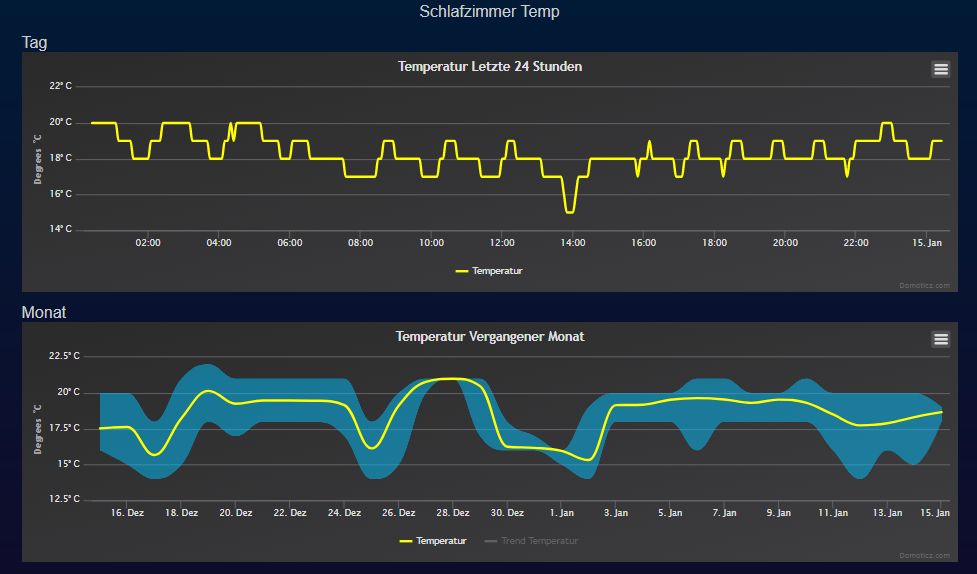

Can others maybe report on how their thermostat graphs look, sharp or smoothed, and what their version number is?
DarkG
- Posts: 89
- Joined: Friday 15 September 2017 18:54
- Domoticz version: 4.10076
- Location: Germany
Re: Python plugin: ELV/EQ-3 MAX!
here is mine
- 122.jpg (54.26 KiB) Viewed 2770 times
