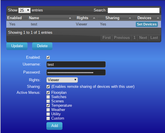

setup=>more options =>edit users
add an [ ]option jsonview allowed ?????
This makes vieweronly user test password test http://test:[email protected]:8080/#/Floorplans
but this user should not be allowed to see almost all superuser info in json
