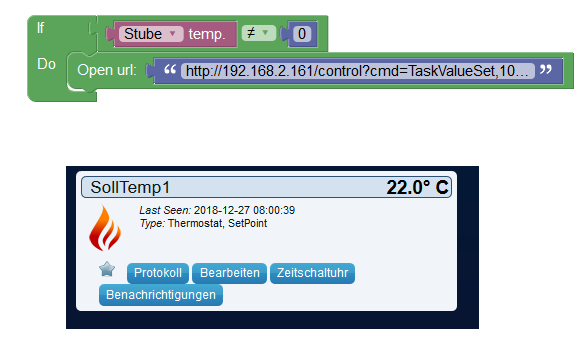

I want to send a Line to ESPEASY and i want to send this for Example http://192.168.2.161/control?cmd=TaskValueSet,10,1,5
this is ok. but when I change the 5 to a Variable (SollTemp1) http://192.168.2.161/control?cmd=TaskVa ... &SollTemp1
then Domoticz send &SollTemp1 and not the value of SollTemp1.
Pleasy Help me I have no more Idea
