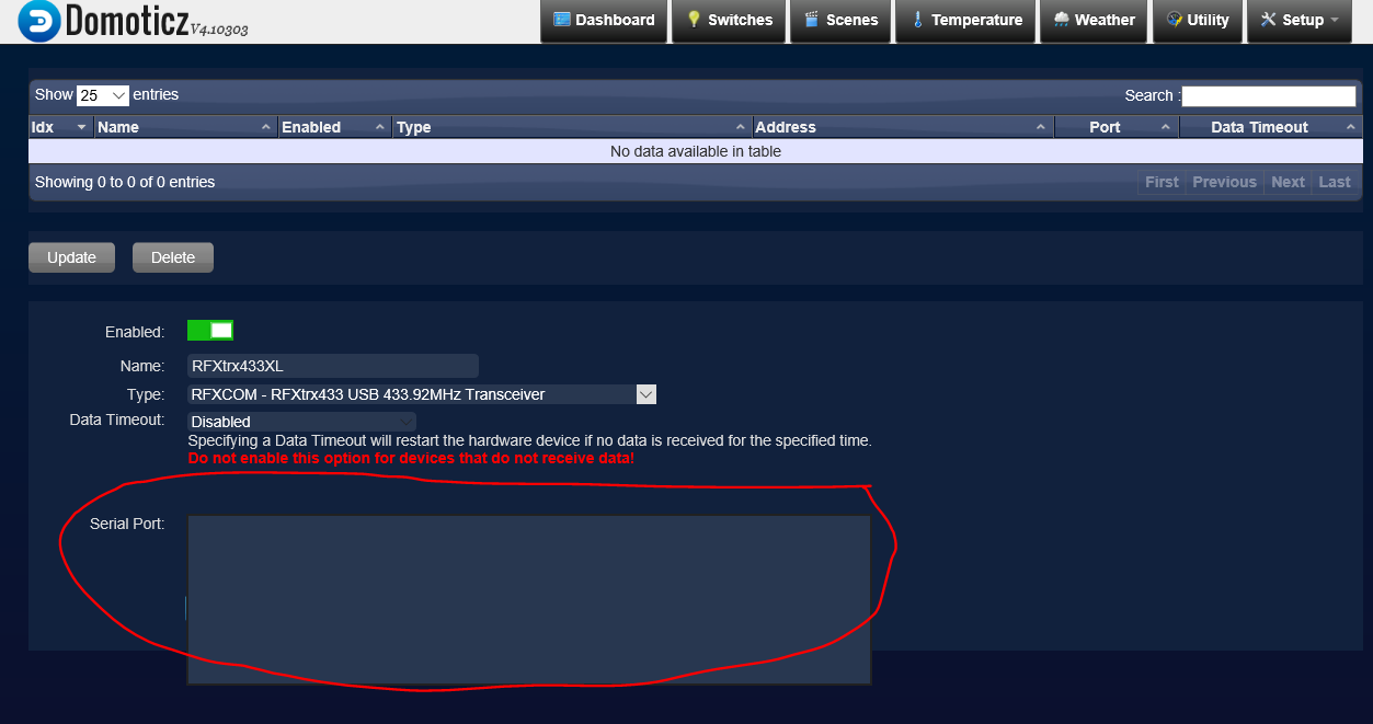

Hello, I installed Domoticz in a LXC container (DOM1) following the howto for Linux.
The website is up and running but my USB RFXcom (RFXtrx433XL) in the host does not show up in the Domoticz hardware configurator.
To be more precise, the "serial port" list is empty. No devices are displayed.
I added the usb device to my container to make it accessible for Domoticz. Commands from within container DOM1:
root@DOM1:~# lsusb | grep 0403
Bus 001 Device 003: ID 0403:6015 Future Technology Devices International, Ltd Bridge(I2C/SPI/UART/FIFO)
root@DOM1:~# lsmod | grep usbserial
usbserial              53248  1 ftdi_sio
root@DOM1:~# ls -l /dev | grep tty
crw--w---- 1 root tty     136,   7 Dec 27 14:44 console
crw-rw-rw- 1 root root      5,   0 Dec 27 15:16 tty
crw-rw-rw- 1 root dialout 188,   0 Dec 27 15:52 ttyUSB0
What can be the reason why Domoticz does not see my devices? The list remains empty.
Domoticz is start as normal user (not root) I added the user in DOM1 to the dialout group.
What can I check to see what is wrong with this setup? Adding udev rules inside a container is not possible in LXD.
Any help is greatly appreciated.

Exact same error here ! Empty list in serial port dropdownlist for all new hardware created :
- LXC container with Proxmox
- Domoticz ultimate beta version (v 4.10303)
- I see in command line /dev/ttyUSB0 and seem to have the good users/right
- Domoticz start as root user
I try verbose mode in Domoticz log without success.
i think the problem is in https://github.com/domoticz/domoticz/tr ... are/serial
