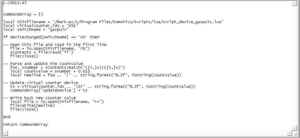

- create a luascript script_device_gaspuls.lua in /scripts/lua, make sure it matches the name given to the switch.
- fill the script with the following code. Adjust the Idx, filepath and switchname to your specific situation
--|55744.690
local thisfilename = "/volume1/@appstore/domoticz/domoticz/scripts/lua/script_device_gaspuls.lua"
local virtualcounter_idx = "44"
local switchName = "gascounter"
if devicechanged[switchName] == 'On' then
-- Open this file and read in the first line
   file = io.open(thisfilename, "rb")
   sContents = file:read("*l")
   file:close()
-- Parse and update the countvalue
   foo, snumber = sContents:match("([^,]+)|([^,]+)")
   local countvalue = snumber + 0.010
   local newline = foo .. "|" .. string.format("%.3f", tostring(countvalue))
-- Update virtual counter device
   ts = virtualcounter_idx .. "|0|" .. string.format("%.3f", tostring(countvalue))
   commandArray['UpdateDevice'] = ts
-- Write back new counter value
   local file = io.open(thisfilename, "r+")
   file:write(newline)
   file:close()
return commandArray
Notes:
- put the current reading of the gasmeter at the top of the lua script in the notation shown
- this value is read & written back to the lua script on every executiuon because of the bug mentioned in this thread http://www.domoticz.com/forum/viewtopic.php?f=15&t=1309
Every time the kaku switch is activated, the script is called and the value of the counter is increased by 0.010.
The result:
The 'today' value is high because i entered this starting value in the script, making it seem all gas was consumed today
I'm curious how long the built in 3V lithium battery of the AMST-606 will last, it switches like 1000-2000 a day....
Update: fixed a small bug in the Lua script which crippled the value when going from .990 m3 to the next .000 counter
Tip: set the device type to 'gas' and the gasmeter setting to 1 to display daily usage correctly

gpio export 23 in
gpio edge 23 falling
And then the GPIO 23 will become available in Domoticz and it will switch whenever the reed switch closes.
