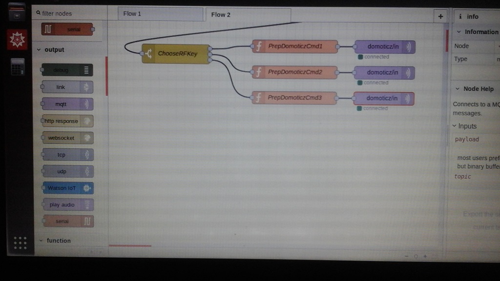

Pardon my late reply. Firstly thanks for the suggestions and Node-Red codes! I just received my new batch of the Sonoff rf bridges two weeks ago and only managed to try out your suggestions over the weekend. I must say it worked a treat!!!
Currently I have the three 433Mhz wireless touch remotes paired to the rf bridge. The Node-Red code looks something like this -
I just needed to change the idx in the PreDomoticzCmdx to the appropriate number. It works exactly the same way for controlling groups and scenes just by entering their idx number and changing the payload.command to 'switchscene" .

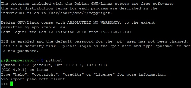

Are you using python3? If so, type
Then type
What do you get?

This i get whwn i type this commands
- console.jpg (52.78 KiB) Viewed 10196 times

i see that if i only type python it say's me the version 2.7.9
And then import the client and i get the same as my last message

If you get an error (not found) message when you type
then this means it hasn't been installed under python (2.7.9), only python3.
python
import paho.mqtt.client-

i don't get an error on both.
not on python and python3
so i asume it should be working.
Only in domoticz it say's in the log no module named paho.

Ok mi changed it but still get this
2018-12-16 19:22:00.718 Error: EventSystem: Failed to execute python event script "Bridge-test"
2018-12-16 19:22:00.718 Error: EventSystem: Traceback (most recent call last):
2018-12-16 19:22:00.718 Error: EventSystem: File "<string>", line 10, in <module>
2018-12-16 19:22:00.719 Error: EventSystem: ImportError: No module named 'paho'
MikeF
- Posts: 350
- Joined: Sunday 19 April 2015 0:36
- Domoticz version: V2022.2
- Location: UK
Re: 433Mhz Touch Remote -> Sonoff RF Bridge -> Domoticz
I've noticed a couple more things in your version of the script:
- under '### substitute your values here ###', you have idx1 = 0 and idx2 = 0; you need to replace these with the actual Domoticx idx's of your devices
- and after 'if rfkey == 1:', you should have idx = idx1
- also, the line 'import paho.mqtt.client' should read 'import paho.mqtt.client as mqtt'
