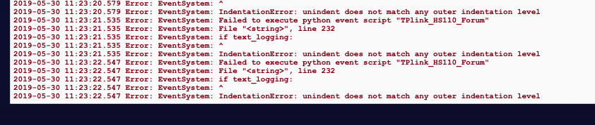

I tried out commenting out pine 227 and 228. Now I get this error:
Screenshot 2019-05-30 at 11.19.36.png (27.18 KiB) Viewed 3159 times

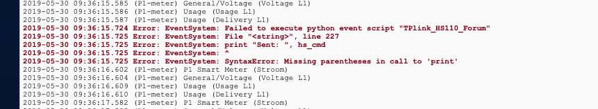

When I started this whole adventure, I have tried replacing parts of the code with the Python3 code, like you suggested, as I figured there might be a conflict between Python versions. I have just added your suggestion to the code, to see what happens. I've replaced:
      print "Sent:     ", hs_cmd
      print "Received: ", received_data
with
        print("Sent: ", hs_cmd)
        print("Received: ", hs_cmd)
the error then becomes:
Screenshot 2019-05-30 at 11.24.00.png (74.71 KiB) Viewed 3159 times

OK, that does suggest that the Python3 script is required for your Domoticz Events option.
The first error complains about urllib2, which is not used in Python3. It would be useful to see what error/s you get if you try the Python3 version of the script.
The second error is usually easy to fix. Python is strict about indents as it uses these to detect which bits of code belong together, like braces may do in other programming languages (my paraphrasing!) The space or tab size of the indent doesn't matter, as long as it is consistent. From around line 235, that section should look something like this:
    else:
      # Direct command, so print to console and exit
      print("Received: ", received_data)
      # write out the text file logs if required
      if text_logging:
        out = time.strftime("%Y-%m-%d %H:%M:%S") + ",Command: " + hs_cmd + ",,\n"
        self.write_file(datafile, "a", out)
      raise SystemExit(0)
However, I think this path will continue with errors until you convert the code to Python3.
