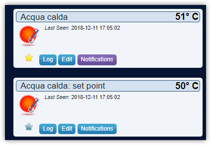

Hello, I did.
Look here https://github.com/gianfrdp/pyIntesisHome
or here https://github.com/jnimmo/pyIntesisHome
I use this script to send water tank temp to domoticz (I have a Panasonic Aquarea HeatPump) with python 3.5, but it works also with AirConditioner.
#!/usr/bin/env python3.5
import requests
from optparse import OptionParser
from pyintesishome import IntesisHome
import sys
import pycurl
import re
import paho.mqtt.client as mqtt
import paho.mqtt.publish as publish
import time
from datetime import datetime
try:
    from io import BytesIO
except ImportError:
    from StringIO import StringIO as BytesIO
def main():
    username="xxxxxx" # IntesisHome login
    password="yyyyyyyyy" # IntesisHome password
    idd = 1zzzzzzzzzzz # IntesisHome device id
    aquarea = None
    temp_idx = 18  # Domoticz IDX
    set_point_idx = 40 # Domoticz IDX
    aquarea = IntesisHome(username, password)
    aquarea.poll_status()
    today = datetime.today()
    tank_temp = aquarea.get_tank_temperature(idd)
    tank_set_point = aquarea._get_gen_value(idd,'tank_setpoint_temperature')
    wifi_signal = aquarea._get_gen_value(idd,'wifi_signal_2')
    print(today.strftime("%Y-%m-%d %H:%M:%S: ") + "Tank temperature = %.1f°C, Tank set point = %.1f°C, WIFI signal = %d" % (tank_temp,tank_set_point,wifi_signal))
    if (wifi_signal > 0):
        msgs = [{'topic':"domoticz/in", 'payload':"{\"idx\":%d,\"nvalue\":0,\"svalue\":\"%s\"}" % (temp_idx, str(tank_temp))},.
                ("domoticz/in", "{\"idx\":%d,\"nvalue\":0,\"svalue\":\"%s\"}" % (set_point_idx, str(tank_set_point)), 0, False)]
        rc = publish.multiple(msgs, hostname="192.168.2.31", port=1883, client_id="pyIntesisHome2")
        print(today.strftime("%Y-%m-%d %H:%M:%S: ") + "Publish: %s" % (rc))
if __name__ == "__main__":
    main()

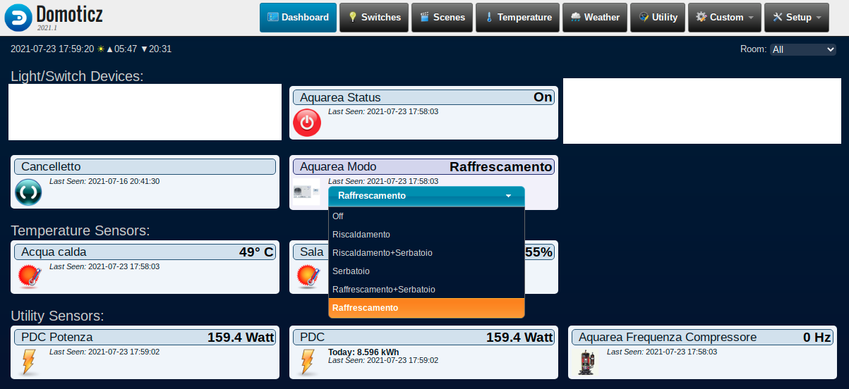

gianfrdp
Posts: 11
Joined: Sunday 10 January 2016 3:22
Domoticz version: 3.8805
Re: Control infrared heating panels + AC (IntesisHome)
Post by gianfrdp »
gianfrdp wrote: Tuesday 11 December 2018 17:11
as my IntesisHome device is dead, and buy another one is quite expensive because is out of production and personally I don't like to connet to a cloud service, I bought a modbus IntesisBox PA-AW-MBS-1 (also outdated as my heat pump is is quite old, by 2012) for more or less same price.
I developed a python library to connect to modbus and send data to domoticz (and also to change heat pump parameters):
https://github.com/gianfrdp/pyModbusIntesisBox
Hope this could be useful to others too
