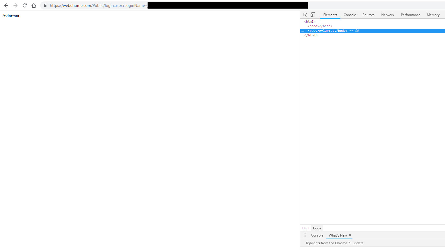

can you show the exact response (screenshot) ? Not clear now if the response if json or xml or other format
What do you mean the get the status into a selector switch ? Should the selector switch switch to the level named disarm, home or away or do you mean something else ?

Yes, i want the selector switch to show the level named disarm, home or away.

The script below does react to the httpResponse and set the selector switch accordingly but there is no translation in it yet.
So for now the selector labels should be exactly the same as the possible returns from the alarm system.
If you need to translate the strings to home, disarm and and away, I need the exact words that you can get from the http call.
