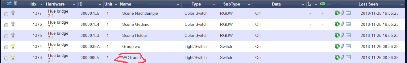

os.execute is really calling a scene, this because in the future there will be more then one light in this room.
The WCTradfri device is really existing, see screenshot below;
Screenshot - 26_11_2018 , 10_21_48.png (36.86 KiB) Viewed 545 times
Above devices were generated automatically by Domoticz after adding the light to my Hue Bridge.

Re: switchOn() or switchOff() HUE light doesn't work
Freemann wrote: Monday 26 November 2018 10:19 The WCTradfri device is really existing
So dzVents isn't seeing the 'WCTradfri' device...
It exists but have not been added to domoticz. Press the green Arrow and add it to domoticz
Freemann
Posts: 94
Joined: Thursday 24 November 2016 14:55
Domoticz version: >=Béta
Post by Freemann »
O i'm so stupid...
Thanks men, that solved it!!
