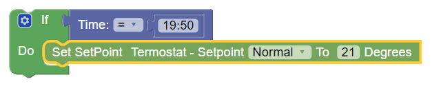

Great job with SVT, thanks anyone involved. I inteend to use it with my Synology. I do have a problem, as such termostat runno problem, I can not change the setpoint temperature by event. Other events like swich on/off work no problem, but setpoint temp not, may you have any advise?
Edit: I,ve soled it this way, time must be set to > or < as event need time to be trigered
