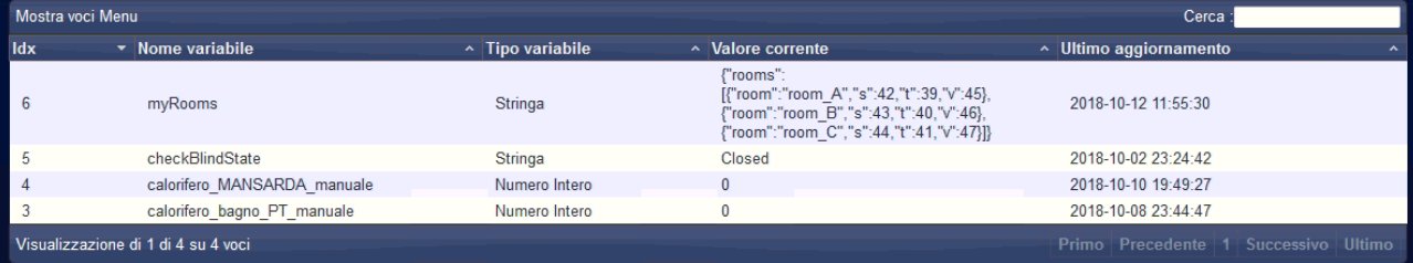

    Before making this script active you should first create a uservariable type string, named myRooms.
    The name and value of this variable are case sensitive and the value must follow this lay-out:
   {"rooms":[{"room":"room1","s":1088,"t":144,"v":1093},{"room":"room2","s":2088,"t":244,"v":2093},{"room":"room3","s":3088,"t":344,"v":3093}]}

        -- Get table from domoticz uservariable
        dz.log(dz.variables("myRooms").value,dz.LOG_DEBUG)
        processRooms(dz.utils.fromJSON(dz.variables("myRooms").value))

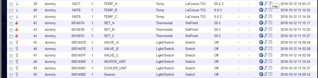

thanks Waaren to your script!! amazing idea using user variable
i study your code (i'm a beginner so it's a good way to understand code) and i play with it just to learn.
    This script manage the different heating zones
    where the strings rooms, room, s, t, v are keys and must not be changed.

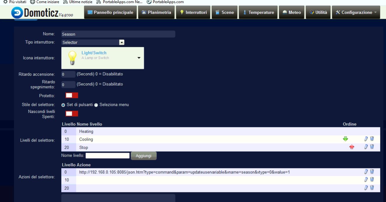

     define a switch for chiller (COOLER_UNIT)
    define a switch for PDC  (HEATER_UNIT)

1) i change the way of controlling heater / cooling just modify the code. now i compare the temperature read from the probe to setpoint. For me is more simple to understand :)
2)i forgot one important thing:
every valve is corrisponding to a circuit, so i open the valve to the related ciruit, but i have also to trigger the relay for heater unit (that is idx48) or when i cooling i need to activate the relay of cooler unit (that is idx49)
in other words, if one or more of valve switch (idx45,46,47) are on -> i need also to turn on: idx48(if i'm heating) - idx49(if i'm cooling)
i solve using:
local heating = dz.devices("HEATER_UNIT") --NAME OF SWITCH FOR HEATER UNIT
local cooling = dz.devices("COOLER_UNIT") --NAME OF SWITCH FOR COLER UNIT
cooling.switchOff().checkFirst() --stop chiller
cooling.switchOn().checkFirst() --start chiller
heating.switchOff().checkFirst() --stop PDC
heating.switchOn().checkFirst() --start PDC
anyway i do not know it they are "elegant" way to proceed :-) but point 1) and 2) are working
now point 3) and $) i would like to implement but i not succeed on that :(
3) in the future, if i want for example to control room_C with the same probe of room_B.
So when the valve B (idx46) is triggered i need to trigger also the valve C (idx47)
i can modify the string like this?
{"rooms":[{"room":"room_A","s":42,"t":39,"v":45},{"room":"room_B","s":43,"t":40,"v":46},{"room":"room_C","s":44,"t":41,"v":47}]}
become
{"rooms":[{"room":"room_A","s":42,"t":39,"v":45},{"room":"room_B+C","s":43,"t":40,"v":46,47}]}
is it possible?
i'm not so confident on array usage :(
4) i do not like so much the solution of putting in the code
 local season = "on 20/3-31/10"  -- Warm season (cooling)
some years could be colder( or warmer) than the previous and so on
and during some month you could have not to use cooling or heating systems :)
so i create a dummy switch (idx=50 name=season) and i set it as a selector
inside the selector i create 3 levels:
0=heating
10=cooling
20=stop
now inside the action i could ser:
0 = 	http://192.168.0.105:8085/json.htm?type=command&param=updateuservariable&vname=season&vtype=0&vvalue=1
10 = 	http://192.168.0.105:8085/json.htm?type=command&param=updateuservariable&vname=season&vtype=0&vvalue=2
20 = 	http://192.168.0.105:8085/json.htm?type=command&param=updateuservariable&vname=season&vtype=0&vvalue=0
and create a user variable named=season
inside the code how i can implement the control:
if season = 1 -> set code to use heater_unit (idx 48)
if season=2 -> set code to use cooler_unit (idx 49)
if season = 0 -> for every value of every temperature probe (idx39 idx40 idx41 ....) never switch on heater_unit (idx 48) or cooler_unit (idx 49). This could be usefull for example during holidays, vacation...etc etc

megamarco83 wrote: Friday 12 October 2018 15:10 i study your code (i'm a beginner so it's a good way to understand code) and i play with it just to learn.
some consideration:
now point 3) and 4) i would like to implement but i not succeed on that :(
0=heating
10=cooling
20=stop

Very good that you are playing with the script and try to change. For me that is the best way to learn !
1. Top
2. Top
3. {"rooms":[{"room":"room_A","s":42,"t":39,"v":45},{"room":"room_B","s":43,"t":40,"v":46},{"room":"room_C","s":44,"t":41,"v":47}]} would become
{"rooms":[{"room":"room_A","s":42,"t":39,"v":45},{"room":"room_B","s":43,"t":40,"v":46},{"room":"room_C","s":43,"t":40,"v":47}]}
-- In this way valve 47 will "follow" valve 46 because they use the same temperature sensor and setpoint.
4. You could also just read the levelName from the selector switch. -- if dz.devices("selectorName").levelName == "heating" then

waaren wrote: Friday 12 October 2018 16:54
5. One way of doing this is using HTTPResponse (see below)
4)
good idea!!
i modify the code:
    the values room1, room2 etc, are the zonenames or roomnames and can be changed
    the value after "s" is the id of the setpoint device in that room
    the value after "t" is the id of the temperature sensor in that room

hi, thanks to Waaren i attach you the code that is working with every room that has it's corresponding setpoint, temperature sensor, and valve
there is also the possibility to have trigegred heater unit or cooling unit (if it's needed)
    version: 20181014-01
    define a switch for chiller if there is a main switch
    define a switch for heater if there is a main switch
   {"heater":1095,"cooler":1096,"selector":"Season","rooms":[{"room":"room1","s":1088,"t":144,"v":1093},{"room":"room2","s":1088,"t":892,"v":1093},{"room":"room3","s":1088,"t":766,"v":1093}]}
    where the strings heater,cooler, selector,rooms, room, s, t, v are keys and must not be changed.

    the value selector is the idx or name of the selector switch that control if the heating or cooling system is active or stopped both.
    the value after "v" is the id of the radiator valve device in that room

When ther is a heat demand i see that the script turns al my valves open(28degrees), but the main heater switch is'nt been activated.
Here is my uservariable input:
{"heater":4,"cooler":221,"selector":"Seizoen","rooms":[{"room":"WoonkamerLi","s":33,"t":45,"v":13},{"room":"WoonakmerRe","s":33,"t":45,"v":15},{"room":"Gang","s":34,"t":187,"v":17}]}
Ive created a selector switch called Seizoen with 3 values, 0 Off, 10 Zomer, 20 Winter
Any clue where i should look?

i Think i found it! The values in the selector switch have been renamed to Heating and Cooling. But now an other error comes in the log:

What happens here is that the script wants to switch a device to an on state. But in your setup this device is not switchable by a dzVents switchOn() or switchOff() function because it is recognized as a setPoint device. So you need an updateSetPoint(setPoint) for that.
If you send me a PM with the types and subtypes of the devices you entered in the uservariable I might be able to amend the script in such a way that it will work for your setup.

Waaren provided me thsi working setup for operatingf thermostat radiator vales with setpoints instead of on/of switching.
    the value heater is the idx or name of the main heater switch. If your system does not have this, leave it out completely
