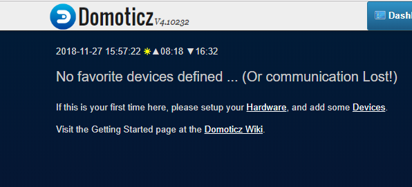

Erik10 wrote: Tuesday 27 November 2018 15:22 From one moment to the other Domoticz is totally empty. No hardware, no, switches, no devices, no log.
How do you define totally Empty ? Is that this message from the Gui or
or this result from sqlite

In the GUI as you showed. No entries. The RPI is connected to the LAN by cable.
The database give a number e.g. 22750 not a zero.
I checked on the RPI, although domoticz is offline, domoticz.service is running.
