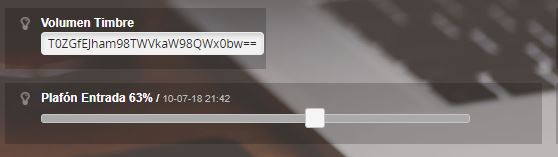

Hi everybody,
i have a problem when trying to add a switch which has a button set or a selection menu with buttons. When i place a dimmer there is no problem, but if i change the switch to a "selector" i obtain at dashticz a text string instead of the buttons. For example, in the attached image , that switch is a selector with buttons (OFF, Low, Medium, High) and what i`m obtaining at dashticz is a text string, only one... I have been searching a lot in the forum, but i didn`t find a similar problem. Can anybody can help me? I have attached two pictures (one with dashticz's problem and one with original switch as shown and fully working with domoticz)
Thnx in advance :)
Switch as shown at domoticz
Switch as shown at dashticz

I have the same problem occurring. But I don't think the problem is specific to Dashticz. The same thing happens when looking at the switches in Domotix or Pilot on my iPhone . Only the Domoticz app shows the selector switches correct. Also see viewtopic.php?f=6&t=24181
So probably something is changed in how the values are passed on and the Dashticz/Domotix/Pilot need to be updated.

I think you are right.... after reading your comment, i downgraded to a previous version of domoticz (in other computer which is not running the domo server) and BINGO, buttons appeared in Dashticz where before i had a text string.... so it seems to be a "problem" of Domoticz as you said.

This is due to a change in the domoticz api. See my previous post about it:
http://www.domoticz.com/forum/viewtopic ... 04#p187204

I just changed js/version.js
from
var levelNamesEncodeVersion = '3.9476'; /* Domoticz version above this, level names are encoded *
To:
var levelNamesEncodeVersion = '3.7476'; /* Domoticz version above this, level names are encoded *
and it worked. 3.7.476 is arbitrary. It only has to be lower as your current version of Domoticz.
I was running Domoticz version 3.9464 so it seems that the versioning was a little off.

i´ve found the Solution.
As the api sends base64 encoded string this must be decoded in dashticz.
viewtopic.php?f=67&t=17427&start=380

Are you using the beta version of Dashticz? It should be solved from beta 2.3.11 onwards.
The master version doesn't contain the fix yet.

You can check whether you are indeed using the beta branch of Dashticz, and not the master branch, in two ways:
* look in [dashticz folder]/version.txt
* Click on the settings icon in the Dashticz top bar, then on the info tab. It shows the Dashticz version.

desertdog wrote: Sunday 17 March 2019 10:33 I am using version V2.3.3
Should things work with this version or do I need the beta? And if so, how do I upgrade to the beta
You need the beta.
For upgrading it's best to install the beta version in a new folder and then copy your custom/CONFIG.js from your current Dashticz to the new one.
Most things are explained in the wiki:
https://www.domoticz.com/wiki/Dashticz_ ... stallation
Probably you have to make some additional changes to your CONFIG.js. For instance the fontawesome icon names have changed: you have to put far or fas in front of the icon names.
