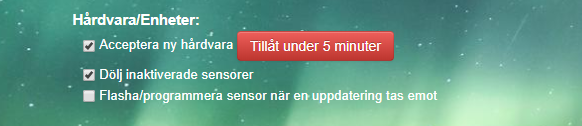

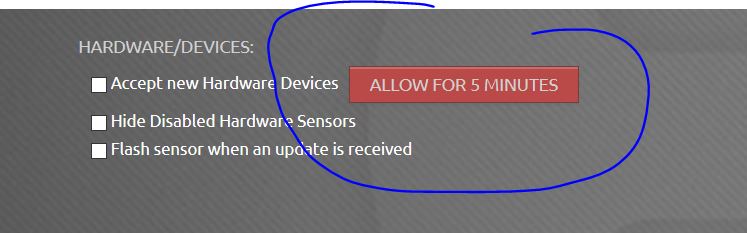

@TheeDude
Does domoticz is allowed to accept new HW/Devices ???

zak45 wrote: Monday 05 November 2018 18:54 @TheeDude
Yes it is!
