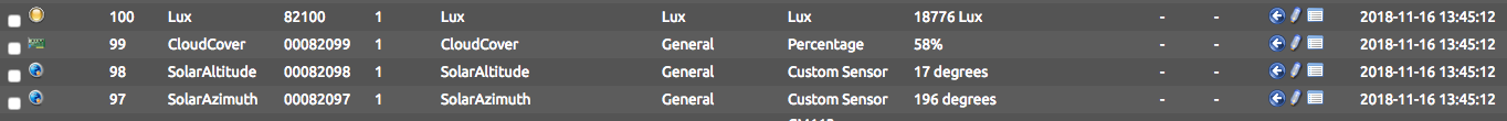

I just discovered this script and since the WU API is not available anymore, I took the liberty to adapt the dzEvent script to use Dark Sky API.
I made some changes to follow JCLB's advices about :
- the pressure (which is defaulted to Dark Sky but can be taken from a device)
- latitude, longitude and altitude have to be set manually since I didn't find another way to detect them
- Cloud cover is retrieved from Dark Sky API and the subsequent algorithm is modified (even if I didn't renamed the variable "okta")
It's a shame that the cloud cover isn't supported by the Dark Sky hardware in DZ. I could have made it "datasource independent" so that it relies only on dz devices.
The script is avaiblable at https://github.com/russandol-sarl/dz-solarData.
Feel free to share ! If you have any improvements in mind, you can tell me and I'll see what I can do.

For some reason i can not get this to work properly.
What am i doing wrong?
local countryCode = 'NL'                              -- Only for log purpose
local idxSolarAzimuth = 97                          -- (Integer) Virtual Azimuth Device ID
local idxSolarAltitude = 98                          -- (Integer) Your virtual Solar Altitude Device ID
local dsAPIkey = '5eba2XXXXXXXXXXXX1'      -- Dark Sky API Key
local logToFile = false                                -- (Boolean) Set to true if you also wish to log to a file. It might get big by time.
local tmpLogFile = '/tmp/logSun.txt'           -- Logging to a file if specified
local fetchIntervalDayMins = 15                  -- Day time scraping interval. Never set this below 4 if you have a free WU API account.
local fetchIntervalNightMins = 30                -- Night time scraping interval.
-- Optional Domoticz devices
local idxLux = 100 -- (Integer) Domoticz virtual Lux device ID
local idxCloudCover = 99 -- (Integer) Domoticz Cloud Cover (PERCENTAGE TYPE) sensor device ID
local idxPressure = nil -- (Integer) Your Pressure Device ID. if you don't have one, the pressure value will be retrieve from Dark Sky API
-- (You don't have to configure these if you accept the values returned by the weather observation station)
local latitude = 52.3389926	-- Latitude. (Decimal number) Decimal Degrees. E.g. something like 51.748485
local longitude = 4.9591888	-- Longitude. (Decimal number) Decimal Degrees. E.g.something like 5.629728.
local altitude = -1	-- Altitude. (Integer) Meters above sea level.
The amount of Lux can't be correct...
Screen Shot 2018-11-16 at 13.52.06.png (46.78 KiB) Viewed 6972 times
hestia
Posts: 361
Joined: Monday 25 December 2017 23:06
Domoticz version: 2022.1
Location: Paris
Re: dzVents version of the Solar Data Script
Post by hestia »
RapTile wrote: Friday 16 November 2018 13:33
hestia wrote: Friday 16 November 2018 12:09 <..>
ocal dev_rain1h = 105 -- dummy receive 1h expected rain in mm / Custom (mm) =>> not rain type but custom type
local dev_rain12h = 106 -- dummy receive 12h expected rain in mm / Custom (mm) =>> not rain type but custom type
local dev_rain24h = 107 -- dummy receive 24h expected rain in mm / Custom (mm) =>> not rain type but custom type
Ok, thanks for the info!
What settings do u use for cloudcover?
Because i still receive the following error message:
Meteo: Method updateCustomSensor is not available for device "CloudCover" (deviceType=General, deviceSubType=Percentage). If you believe this is not correct, please report.
device "CloudCover" => General Custom Sensor /!\ not a % device
after in the axis of the custom sensor you put what you want, there is no unit for the cloud sensor
