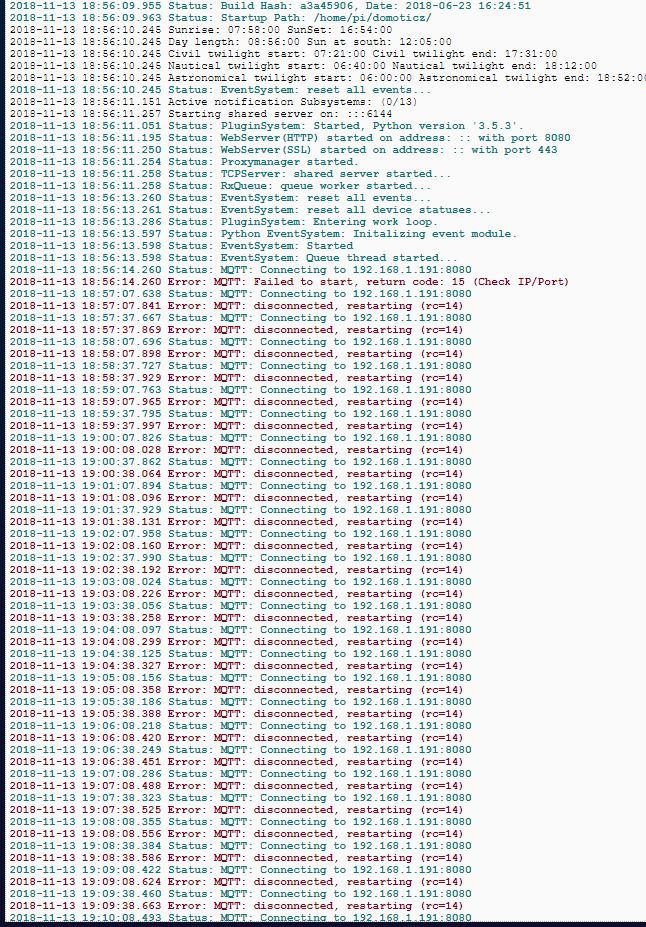

I have installed Domoticz on a raspberry pi 2, i got some sonoff switches which i flased with easy esp. They work but i constanly get errors in my log.
What is this and how can i fix this?
Mqqt problems.JPG (244.72 KiB) Viewed 294 times

Matthiasvz wrote: Tuesday 13 November 2018 19:39 I have installed Domoticz on a raspberry pi 2, i got some sonoff switches which i flased with easy esp. They work but i constanly get errors in my log.

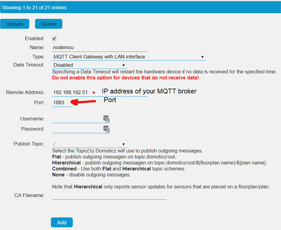

It looks like that you entered your domoticz port in the hardware settings of MQTT in domoticz. Port should probably be 1883
