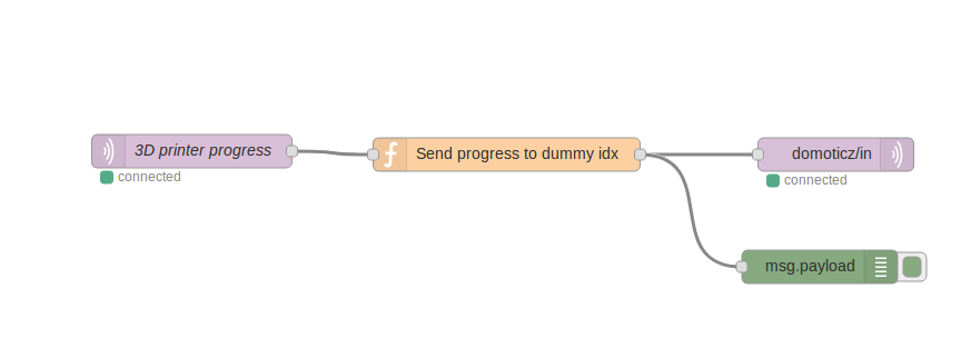

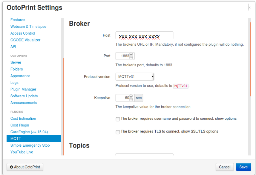

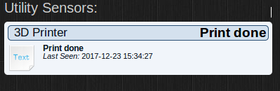

Hi, I was searching for exact same solution and I have something working, I only need to understand if print is in progress or done, I don't mind temperature so this you need to fix yourself...
It requires octoprint + mqtt plugin. The MQTT plugin to be setup to your broker (my broker is mosquitto running on Domoticz RPI server)
Then on your domoticz server it's required:
mosquitto + node-red, setup here: http://www.domoticz.com/wiki/MQTT
also to setup a dummy text device, my idx: 224, so you need to modify idx accordingly
when node-red is working, check your server:1880
then CTRL-i and insert the below text, as this will setup your flow, my idx: 224
[EDIT 2018-01-05] as I had a minor bug and comma was shown in percentages below 10 was showing up as 5,% (if the number was 5%)
[{"id":"5d05beab.45536","type":"function","z":"5828a86.49629d8","name":"Send progress to dummy idx","func":"//Get progess 0-99\nvar progress = parseInt(msg.payload.substring(13,15));\n\n//Clear msg buffer\nmsg.payload = {};\n\n//Set dummy idx number here:\nmsg.payload.idx = 224;\nif (progress === 0){\n msg.payload.svalue = (\"On\");\n} else \nif ((progress >= 0) && (progress < 99)){\n msg.payload.svalue = (\"Print progress: \"+ progress +\"%\");\n} else \nif (progress == 99){\n msg.payload.svalue = (\"Print done\");\n} else {\n msg.payload.svalue = (\"Printer off\");\n}\n\nreturn msg;","outputs":1,"noerr":0,"x":486.5,"y":184,"wires":[["e5923d30.e4c248","a52de4f4.5fcb1"]]}]

In octoprint you specify your mqtt broker ip address, I have put here xxx.xxx.xxx.xxx, no need to change anything else

Hey, thanks for doing all the hard work for me! Took me a while but think I finally have this working. I wasn't really happy with the function parsing the payload as text when it was effectively a JSON string so I think doing this is better:
var varPayload = JSON.parse(msg.payload);
var vartemp = varPayload.actual;
I think this allows for the payload changing in the future.
Full code from the function
//Clear msg buffer
msg.payload = {};
msg.payload.idx = 12;
msg.payload.nvalue=0;
msg.payload.svalue = (""+vartemp+"");
return msg;
I've also created a couple of flows for the bed and extruder temperature: I'll see if I can export them and add them to the next post

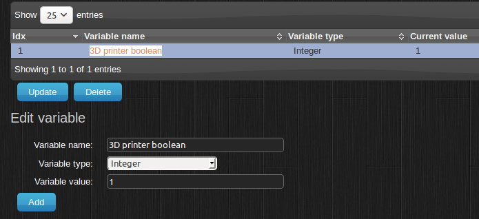

And then I have created this LUA script, that will switch on a lamp when 99% done.
First create a user variable: 3D printer boolean and make this an integer
then copy this script as lua, like this:
-- created by [email protected] 2018
-- loop through all the devices
for deviceName,deviceValue in pairs(otherdevices) do
    if ((deviceName=='3D Printer') and (uservariables["3D printer boolean"] == 0)) then
        if otherdevices_svalues['3D Printer'] == "99%" then
            --uservariables["3D printer boolean"] = 1;
            commandArray['Variable:3D printer boolean']='1'
            print ("3D Printer event fired");
            commandArray['Kitchen HK Lamp'] = "On"
if otherdevices_svalues['3D Printer'] ~= "99%" then
            --uservariables["3D printer boolean"] = 0;
            commandArray['Variable:3D printer boolean']='0'
return commandArray
