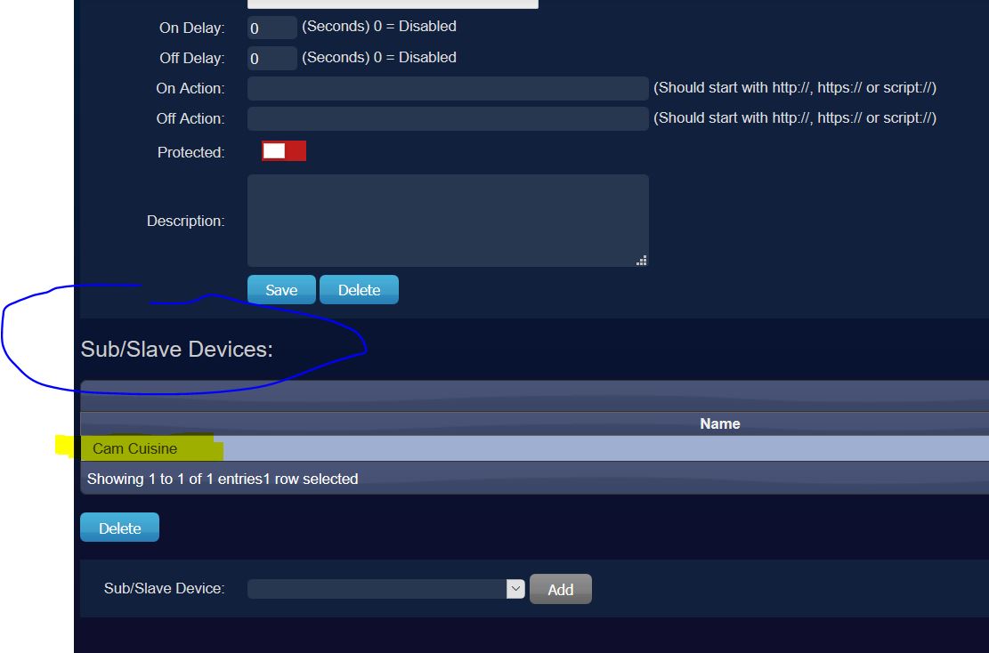

second:
this should give you one possible way to go, without any scripting

Thanks zak45,
I thought the sub/slave option would work for another option I want but I can't get it to work properly either, or at least how I think it should work.
Sorry to be a pain but is the below not possible?
I have a LWRF relay connected to a garden light, I have this setup in Domoticz as an on/off switch, pressing the lighbulb in the switch via the gui turns the light on and off, works great, no issues.
I created a switch in domoticz as a push on button with an on time of 10 sec (as a test) it then auto switches off as expected, I've added this switch as a sub/slave device to my garden light switch so if I press the main garden light switch the light is on till i turn it off, if I press the push button as its linked to the garden light it should come on for 10 secs and go off right?
Well when i press it the button changes state and so does the main garden light switch in the gui then after 10 secs they both go off but the actual light does not come on, it seems that its all working except domotics isnt sending any commands via the RFXCOM, i thought if the switch was showing as changed in state the command should have been sent.
