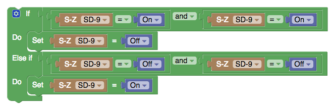

i guys, a simple blockly that not do nothing (and i don't understand why).
I want that a virtual device (allarme casa) go on when i and my sister go out
call this blockly auto alarm
where is the wrong thing?
A simple blockly

Hi, i think it's the "double use" of On and Off....
Try it in a way like this:

it seems to be ok now, thank you so much @bewo
