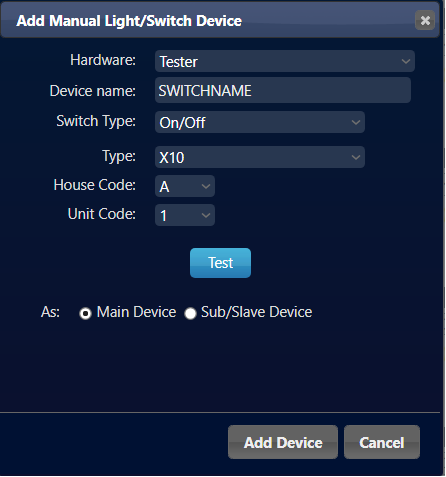

I managed to create dummy hardware and then manually add the virtual switch (included in the picture)
I tried it with the different lua devices scripts but no in lua device instead of lua all with a simular result
