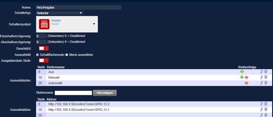

Post by DarkG »
And here the selector
RPi4 Shelly1 Shelly2.5 ESPEasy Tuya Domoticz Beta Dashticz 3.6

I know what you are thinking. In your way you have to store the original Setpoint and write it back. For each valve.
But what, if you create a second uservariable called intern heat demand, so each valve can change this one variable.
And with this and a AND Block you can request Heat.
So if Setpoint reached you change the Variable to ON.
mvzut
Posts: 443
Python plugin: ELV/EQ-3 MAX!
Post by mvzut »
DarkG wrote:I know what you are thinking. In your way you have to store the original Setpoint and write it back. For each valve.
Not sure how that changes anything... The end result is still that you want to turn off the boiler earlier than the valve position would indicate, right? But what if one of your other rooms has (real) heat demand at that time? Then you cannot switch off the boiler. So the room that had already reached its desired temperature will still be heated. Unless you actually close that valve, which can only be achieved using a setpoint change.
Vice versa, turning on the boiler earlier than the valve position indicates also won't work. Since it doesn't make sense to turn on the boiler when the valve is closed. Also here the only solution is to change the setpoint (this time to something really high).
I have an idea :
What if you create virtual switches for all your valves, which do nothing else then send a JSON command at the On and Off action (see one of my posts above for the exact command). This JSON command sets the thermostat of that valve to either 8 degrees (Off action) or 25 degrees (On action). You can then install Smart Virtual Thermostats (another Python plugin) for every room, indicating the IDXes of your temperature sensor, your newly created virtual switch, and even an outside temperature sensor if you want. The disadvantage is that you throw away the gradual valve control that MAX's own system uses, but in return you get the option to use another temperature sensor, plus a controller with self-learning behavior, even taking the outside temperature into account to determine when it should switch on.
