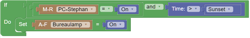

tried to creat a blockly but i cannot make it with some dependancies.
if i turn on my computer i want that my desklight to be turned on, and if i quit computing i want it to turn off, for that i have the following:
and for off:
pretty much straight forward, no big deal and works like a charm.
only i want to extend it that if it is past sunset the light wil go on, otherwise not.
i tried several options like the one below but it doesnt work at all.
what may go wrong and can someone help me out here?

The Blockly with the check if it is past sunset is not correct.
It will test if the state of the PC is ("On" and time > sunset) This will lead to an unknown comparevariable logic_operation
A correct Blockly is:

Thanks for the clarification, it make sense, i must keep in mind that a state is not transfered to another block.
thank you for the help, it works now

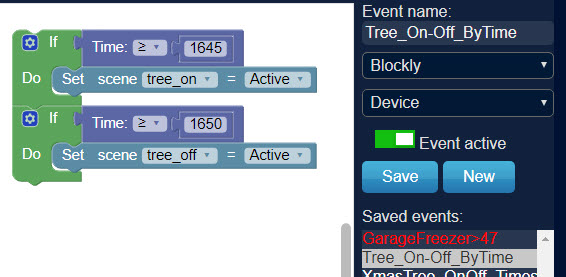

Hello
Why is this [my first blockly] not working?
Re: Blockly examples
jimbo213Mo wrote: Monday 10 December 2018 18:41 Hello
I am no blockly expert but the blocky below works.
Differences with yours:
Only one If Do block
Time is = hh:mm not >=
Time is entered as hh:mm not hhmm
Scene is set to "On" not "Active"
I am on a recent Beta and cannot choose between Device or Time based blockly but if you can choose, I would go for a time based event.
"your mileage may vary" but this can be a start. Try from here and adjust to see if the blockly keeps working after your changes.
