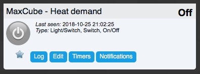

Re: Python plugin: ELV/EQ-3 MAX!
I have released an update of the plugin again on Github (version 0.6.0).
This version has an option to create a "Heat demand" switch, which will be turned on when at least one valve requires heat (i.e. if it is open for more than 25%). This 25% is not configurable at this stage, nor is the amount of valves that need to be open before the "Heat demand" switch is turned on. I may add this configurability later. However, since Domoticz plugins do not support more than 6 user-configurable parameters, this will only be possible if I remove other configurable parameters (e.g. the optional creation of certain devices). Actually, I already had to remove one of them (the optional creation of temperature devices) to make this new option possible.
You can use the new "Heat demand" switch to control your boiler. The exact execution of this will differ per situation, since all boilers work differently. You may have to send a command via http, or switch on another device that controls your boiler's thermostat. You can achieve this by creating (Blockly) scripts or configuring other devices as slave of the "Heat demand" switch.
Let me know if this works for you!
P.S. Please restart Domoticz after updating the files with the git commands mentioned in earlier posts. After restarting, go to Devices and set the parameters (again). This is necessary because I made some major changes there.

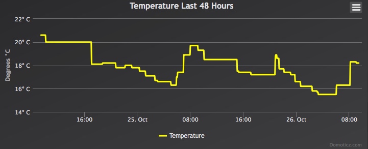

I have this running for a while, seems to update temperature more often now. Have others tried it? If it works well for more people, I might consider adding this functionality to the plugin.mvzut wrote: Wednesday 17 October 2018 21:41 Interesting! Apparently you don't have to switch to Boost mode per se, any mode switch will do. You could do that by this (slightly modified) Lua time-based script:I'll check for a few days if this really works (be my guest to try it as well!). If it does, I'll have a look if I can build something like this into the Python plugin (as a selectable option).Code: Select all
Ok gracias...mvzut wrote: Friday 26 October 2018 19:59No, the internal editor is also fine, just make sure you set it to time-triggered.AurelioF wrote:I'm about to try the last update of the plugin and I also want to test the script that acts on the valves every hour, I can use the domoticz editor to include it, or it is necessary to write the file in the folder ~ \ domoticz \ scripts \ lua
Después de actualizar el plugin encontrarte algunos errores en el log.
Tengo 2 válvulas al 40% y 60% pero Heat demand aparece siempre OFF

Ok, I'm not sure I completely understand... Is it working now? And does the heat demand switch work as expected?
AurelioF
- Posts: 33
- Joined: Wednesday 03 October 2018 18:01
- Location: Spain
mvzut wrote: Friday 26 October 2018 21:01 Ok, I'm not sure I completely understand... Is it working now? And does the heat demand switch work as expected?
Sorry, my english is not good ...
The heat demand switch does not work, it always remains OFF

Until the last update, the operation of the valves was correct, the problems began with the update.mvzut wrote: Saturday 27 October 2018 9:51Are the valve percentages updated correctly? And did everything work correctly in the previous version? Somehow (one of) your valves report "None" as percentage. I could send you a version with even more logging to find out what's going wrong. But this will have to wait until tomorrow, no time today. In the meantime, you could try the Lua test script from the Domoticz EQ3 Wiki, and check if all valves report their values correctly.AurelioF wrote:The last 4 lines are repeated periodically.
Today I plan to start from the beginning, I will keep you informed.
Thank you
AurelioF
- Posts: 33
- Location: Spain
I started a clean installation, I'm using Domoticz V. 4.10111, Python Version: 3.5.3, the installation of the plugin worked fine, but after a few minutes it gave an error message.
2018-10-27 20: 57: 19.660 Error: hardware eQ3 (2) thread seems to have ended unexpectedly
After this, no more errors appear, I work all night correctly, but the Heat demand switch never worked, not once.
It seems that - Heat demand does not respond to the heat demands of the valves.
