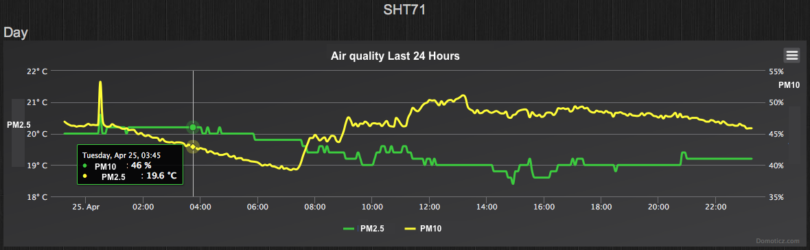

However, the only 'Air Quality' sensor in the predefined list is the Voltcraft CO2 sensor, and the Dylos measures something completely different.
Also, the graph does not appear with the two svalues.
Q: How does one create a device for a new type of signal and how does one create a double graph for these values?
Preferably something like this quickly photoshopped adaption:
