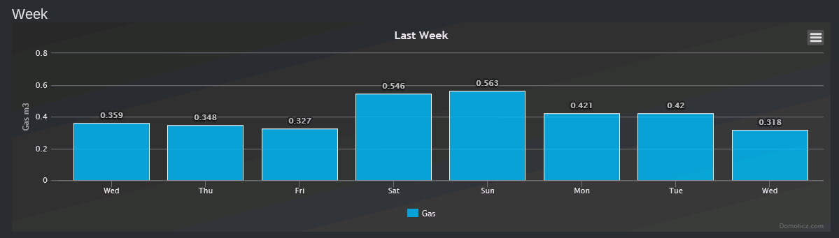

I wanted to calculate the degree day. So I can compare my gas usage with the outside weather. So I was uploading my P1 gasmeter counter to mindergas.nl See this wiki page: https://www.domoticz.com/wiki/Mindergas.nl
But; I wanted to register this information in Domoticz. So I created a LUA script that calculate the daily gas consumption based on the degree days and put that in a counter in Domoticz.
The script is working. See screenshot (I’m currently renovating my home, so the usage is currently not constant…)
