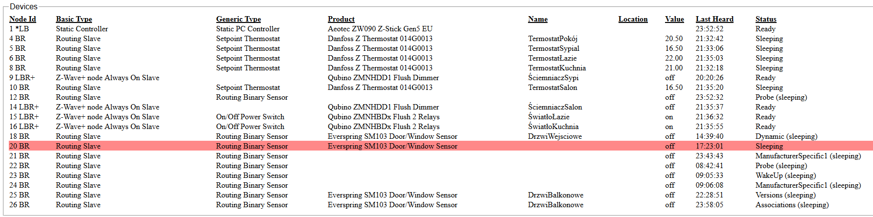

I am wondering if I should somehow get rid of the nodes 20-25? How? (Take a look at the screenshot attached).
Currently the device, door sensor, is included with Node ID 26. As I was struggling to make it respond again I have factory reset it a few times and re-included. Last time it worked it was given Node ID 20. Now it has assigned Node ID 26. I 've followed advice from an other thread and after Test&Heal from Control Panel it communicates again. Unfortunately still doesn't trigger when I open the door. I hope adding it to the 1 group will solve it.
- zwave-sensors.png (84.3 KiB) Viewed 3329 times
- gizmocuz
- Posts: 2712
- Location: Top of the world
Re: How to add support for a new Z-Wave device
If you read the manual of the node, you might see a section about 'groups', there is a lifeline group (most times group 1, but not always!)
Make sure the controller (node 1) is in the lifeline (from the dropdown groups/network)
