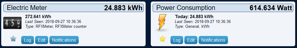

Ref. to this thread where I've been looking for a solution to support 3 RFXMeters but where one of them are using 1000 Imp/kWh and the two others are using 100 Imp/kWh. For now I have an acceptable workaround when it comes to be able to see the power consumption using dummy device and LUA-script which include counter divider settings. But, for the main RFXMeters I will have wrong calculations.
The request is to include a counter divider settings per Energi Meter/RFXMeter counter. Below the left device is the standard RFXMeter counter and the right device is the one using LUA-script to show the Power Consumption (includes a compensating counter divider setting):

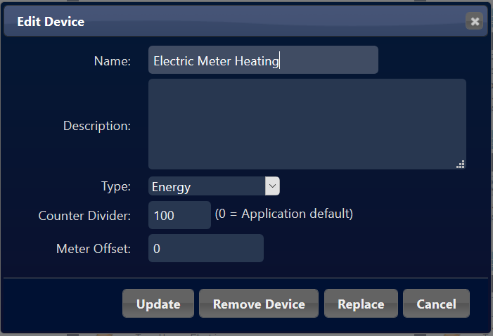

Post by kimhav »
The suggestion of adding counter divider parameter on RFXMeter level has been included as of Domoticz beta v4.10050 and has been verified to work as well. Here is how it looks like now in the RFXMeter:
