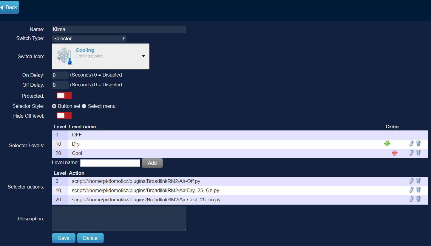

I running domoticz 4.9700 on RPI3.

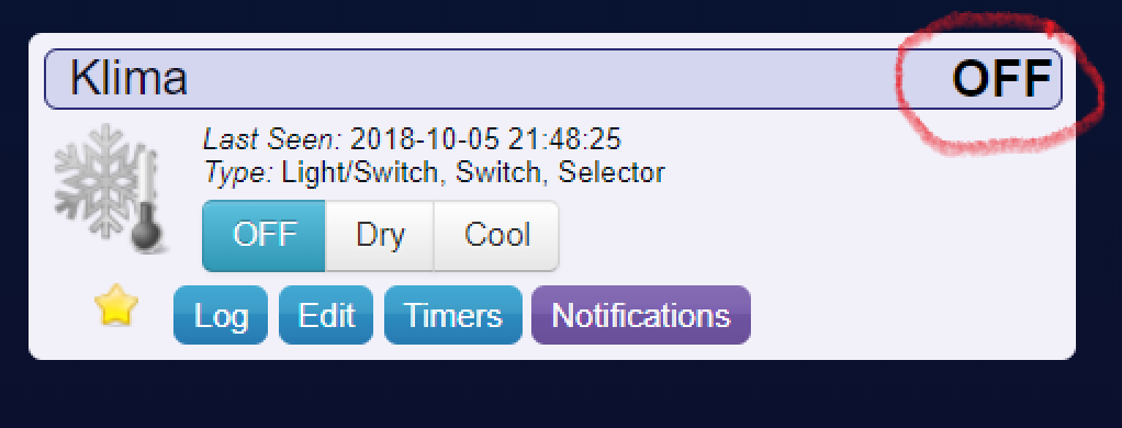

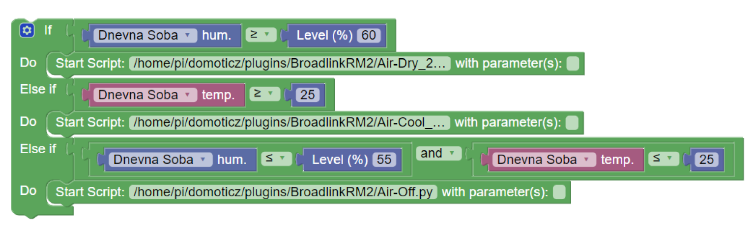

I cannot figure out why my blockly isn't refresh switch type selector . I hope you guys can give me some advice and help me to solve my problem. I create script when humidity grows over 60 then run air-condition in drying mode till 55. and if temperature grow over 25 then run air-condition in cool mode. If humidity under 55 and temperature under 25 then air condition switch off. The script which I create work but have some problem with refresh on dashbord status of switch selector.
switch type selector dosen't refresh status

The selector switch starts one of the scripts if the matching level is set. The blockly you use, starts one of the scripts if the matching condition is met. Executing the script as entered in the action field of the selector switch does not set the matching level of the selector switch. It is working only in one way (level ==>> action)miskec wrote: Tuesday 09 October 2018 19:58 I running domoticz 4.9700 on RPI3.

I doubt if it possible at all to set the level (0,10,20 etc...) of a selector switch with blocky. But I am not very experienced using Blockly maybe someone else knows ?
