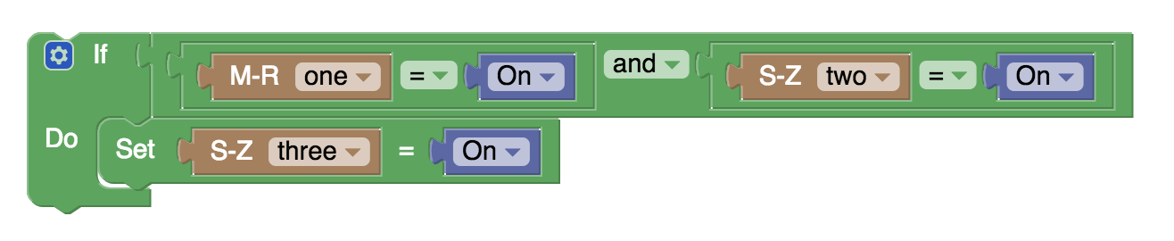

For some reason i can't get some events to work so i tried to work with some demo switches to test a simple script.
For some reason this isn't working.
The attachment Screen Shot 2018-10-09 at 19.15.53.png is no longer available

The "Show current states" window
Screen Shot 2018-10-09 at 19.15.53.png (50.44 KiB) Viewed 1172 times
Eventsystem is enabled in the settings menu.
I updated to version: 4.10049 but this doesn't get it to work either.
What am i doing wrong here?
Thanks in advance for your help!

Replace the "if do" block with the one without the blue gear. The one with the blue gear only works if there is an else condition added.

StanHD wrote: Tuesday 09 October 2018 20:01 Replace the "if do" block with the one without the blue gear. The one with the blue gear only works if there is an else condition added.
Wow, it was that simple...
Thanks a lot!!
