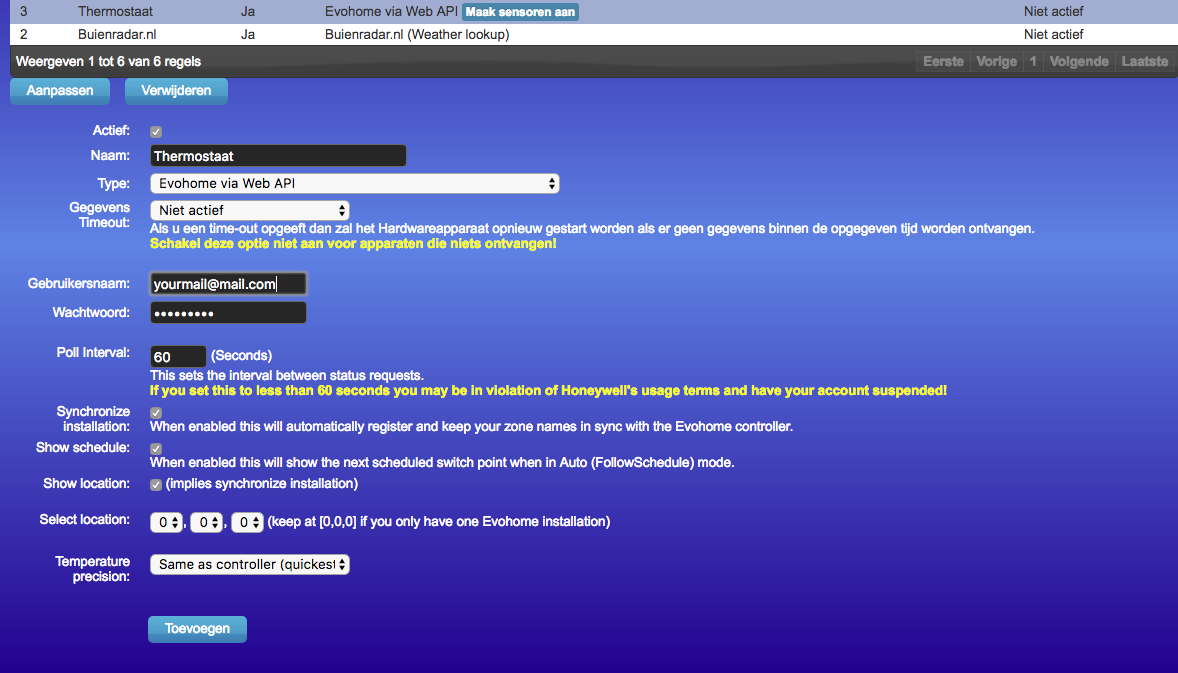

Just add the "Evohome via Web API" by going to settings ---> Hardware
See the screenshot attached. I used my login from honewell to control the thermostat.
