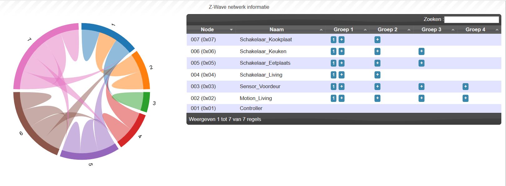

This i my mesh now and the distant between the the switches i not more then 4 meter.

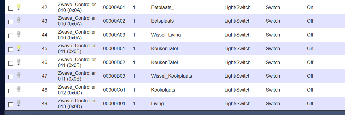

The neo zwave wall switches have a setup different than most switches. They present themselves as multiple devices in one: one for each 'gang' the switch has plus an extra device that can be configured to control any or all of the gangs together. I don't know why neo does this, but it makes qorking with the switches a bit more complicated. For the 1 gang switch you get a device 1 plus another device 2. Both are shown as switches. The actual switch to use is device 2. Device 1 may switch the light also, but it depends on the switches configuration if it does.
For the 2 gang switch you even get 3 devices. 1 is the configurable all/some combination switch, 2 and 3 control the both loads.
That said, if you are on a recent domoticz version you will probably not get all the devices installed. There seem to be some significant errors in z-wave support currently. Among other problems these errors cause all devices that contain multiple nodes not to be recognized any more. For me all such devices no longer work since i installed the latest beta. There are many more z-wave errors in the latest code bases, but this one really breaks my entire setup.

i notice this weird setup from the zwave switches.
The Switch with the _ behind the name is the 2 gang "together" switch.
So i filtered this out in the 2 gang
But in the 1 gang i only got 1 switch and not 2 ?
You thought may be in the correct way,because from the 2 gang i can perfect switch the one gang on and off with the filtered switch.
The problem is from the 1 gang to the 2 gang.
Only strange that i did not get 2 devices on the 1 gang switch.

That is the bug i am experiencing too: multi node devices aren't correctly recognized.
