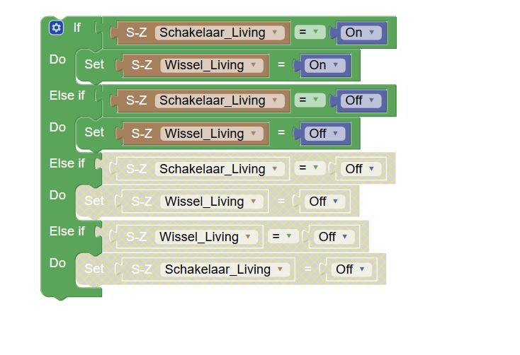

My dzvent wont work anymore sinds i moved from sonnof to Zwave.
The wissel send a command to the other switch but the other switch does not send a command to the wissel.
The strange thing is that it work by switching te lights on and off in domoticz self.
SO now i try to get this work with blocky but now i cannot turn on my lamp anymore :lol:
If i switch on of the 2 (wissel of schakelaar) then i a second it's turn of again :mrgreen:
So i think i made a loop but i cannot find how to fix=
My script in dzvents wit my sonoff

and my blocky

hello Waaren
i'm using the latest stable version.
I'm at "avondschool" now but when i'm home i will try your script
Weird that the script worked before on sonoff but not on Neo. ;-)

nope same effect :-(
when i switch on and off from the schakelaar living then the wissel stay the same
log

so if i activate the lamp from wissel the schakelaar living get activted to.
If i shut down the lamp from wissel the schakelaar is deactivated to.
if i activate the lamp from schakelaar the wissel stay off
if i shutdown from schakelaar the wissel not change
It's looks like the schakelaar did not give the command to the wissel.

i have compared the script from manual switch the schakelaar living and from within domoticz and this is the only change
 2018-09-27 22:16:05.428 OpenZWave: Domoticz has send a Switch command! NodeID: 4 (0x04)
2018-09-27 22:16:05.436 (Controller) Light/Switch (Schakelaar_Living)
2018-09-27 22:16:05.641 OpenZWave: Domoticz has send a Switch command! NodeID: 5 (0x05)
2018-09-27 22:16:05.645 (Controller) Light/Switch (Wissel_Living)
i dont think it's the switch himself who is broken because i have the same setup in the kitchen and i got the same problem

2018-09-28 23:17:42.806 Status: dzVents: Info: ------ Finished Wissel_Living
I dont get it anymore i have the same setup in my kitchen and exact the same errors.
But like i say ,now bold the Sch does not come up anymore in domoticz with manual manipulation en yesterday well.
Today i put my sonff's to my second floor ,reconfigured the name's change the script and the 2 wissels working perfect :-)
THx for trying to figure out this problem

just find something out by accident.
If i put on the Wissel then the Sch go on to.
But if i turn of the Sch the wissel did not change.
BUT if i power on the Sch again on and THEN power off the wissel turn of 2 and then it's works .
But if i manupilate te wissel again i need to do the dubbel tap on the Sch everytime?
And then domoticz update 2 with the correct state in the dashboard.
Shouild it be somtehing to do with these settings?
I enabeled now and see if it's changed tommorow.
Relay On/Off States Saved Enable:
This parameter defines the on/off status of relay needs to be saved. The status will be saved when relay status is changed if this parameter is set to '1'. Otherwise the relay stataus is not saved. The Light Switch will restore the relay On/Off status when powered again.
Gianni
Posts: 230
Joined: Saturday 21 July 2018 19:03
Location: Home@Belgium
Re: help with blocky wissel
Post by Gianni »
found out it's not the script it's a problem with the 1 gang Neo Switches.
