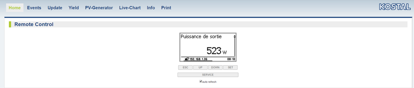

Thanks for your answer. I think the problem is that my inverter is a piko 3.0 MP and the webinterface is different than for the other versions (piko MP 5.5 for instance)
Kostal Piko 3.0 MP web.png (55.19 KiB) Viewed 3524 times
I'm not an expert but it's like a "picture" (frame?) of the screen of the inverter instead of a simple table of values.
So I guess it's not possible to retrieve data from my inverter...?
