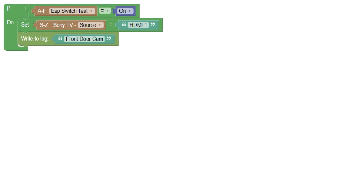

alarm_guy1
- Posts: 132
- Joined: Tuesday 14 January 2014 0:03
Re: Python plugin: Sony Bravia TV
I know this is an old thread and Github declares this as "No longer maintained", however does anyone know in Blockly how to change the source.
I have as per the attached image and it wont change the input.
cheers
cheers
- blockly 1.jpg (40.49 KiB) Viewed 2809 times
